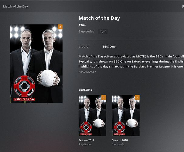

"Season 20XX" seasons result in incorrect matching
Both of the following files match to Season 2017 E2 - MOTD - 12th August 2017 despite the fact one of them isn’t even in the same folder? I don’t have a Season 2018 for some reason?
/TV/Match of the Day/Season 2017/Match of the Day - 2017-08-12 [HDTV-720p X264 8bit 5.1ch AC3]-VERUM.mkv
/TV/Match of the Day/Season 2018/Match of the Day - 2018-08-11 [HDTV-1080p X264 8bit 5.1ch AC3]-VERUM.mkv

Thanks for looking at this Chuck. If you have no files in Plex and then add a new library containing these 2 files below, do you see it match to Season 2017 E2 - MOTD - 12th August 2017?

Not seeing an issue here yet.
At which folder did you point the library in Plex?
It must be /TV
and not /TV/Match of the Day
Correct,
The TV library points to the top level directory containing all the series.

I’m afraid not. I am using unionFS to merge a local read-writable directory with a read-only cloud mount so my files begin with the following…
/mnt/unionfs/Media/TV/TV/etc...
Not sure if this has anything to do with it but it shouldn’t…
