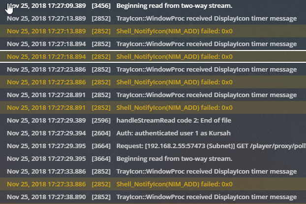

  • A specific error I kept seeing repeated in the console is that 2852 Shell_NotifyIcon(NIM_ADD) failed: 0x0, not sure if that’s worth noting here or not.
  • Here’s a quick snip of my console screen from a few seconds of monitoring. Again not sure if that’s useful or not. Hoping the logs I submitted are though.
