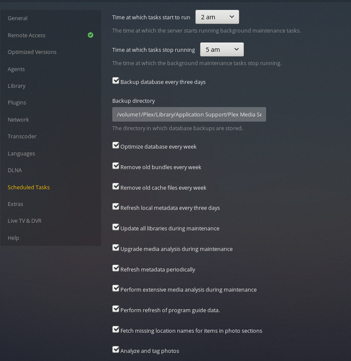

  1. Minor housekeeping to keep the system running wel. (Database Optimization)
Please make sure database optimization is enabled in Schedule Tasks and the system is running during that time so the butler will

Thanks @ChuckPa for the quick response.
  1. Issue 1 should be resolved now. At least it’s using the temp location with the correct user perms. That /transcode setting was carried over from when it was running in a docker container. It’s now running natively on a synology.
  2. This is weird as I’ve had this enabled for months (if not longer). And this runs 24/7 on my synology. At any rate, I’ve manually initiated the optimize the database task.
Thank-you again for the help.
