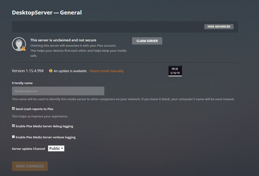

I’m currently running Ubuntu 18.04.2 LTS on the server and recently upgraded from 16.04 LTS. Ever since the upgrade, I have been unable to claim the server, or once it is claimed, somehow gets unclaimed. On perhaps an unrelated note, the server constantly thinks there is a newer version, even when I’m at the newest version. This is a screenshot from just this morning when I was trying to fix the issue.

Completed Every step and it didn’t work. It won’t show back up in my authorized devices, and still has the same problems as above described. Here’s the Logs since it may be more helpful than saying it didn’t work…
