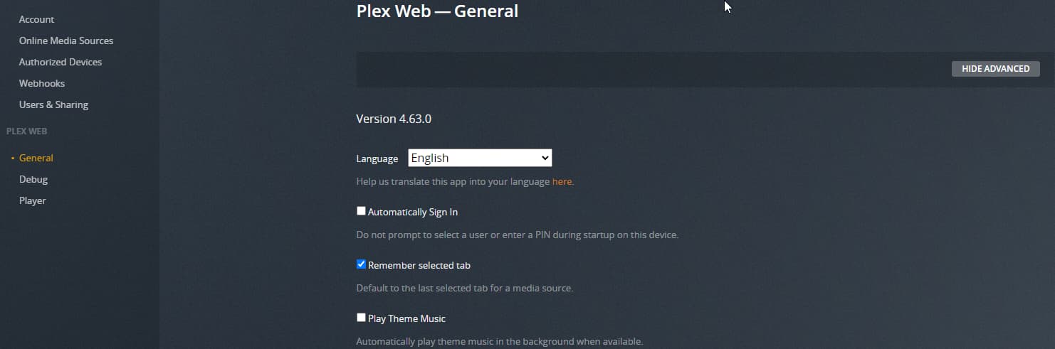

When it comes back up… Settings - Server - Network - Show Advanced,
If you don’t need IPv6 on the lan, turn it off there. PMS will be quite happy on IPv4.
