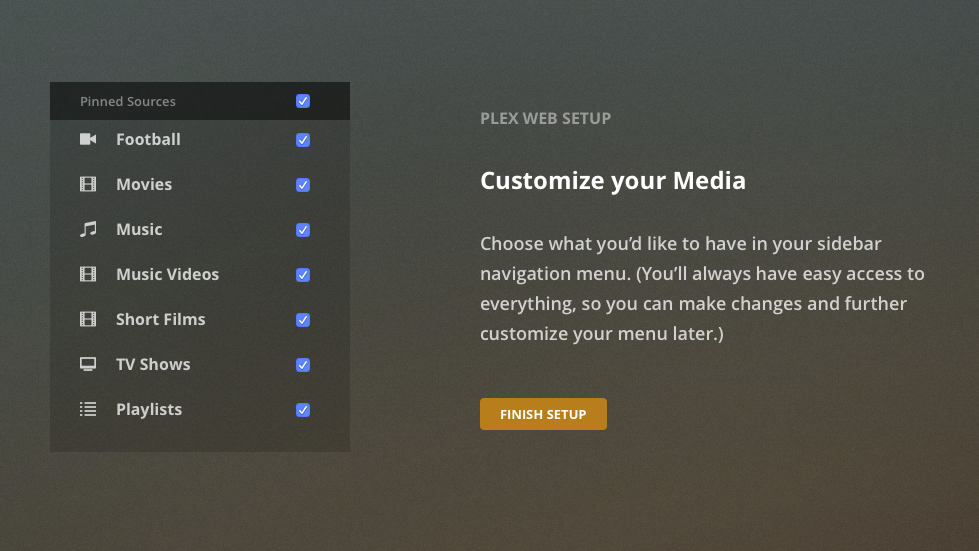

Went through all the steps on FAQ 25. When I signed in it went immediate to
After clicking finish it shows me my normal Home screen, but all the sections show this Screen Shot 2020-03-31 at 9.34.57 PM
