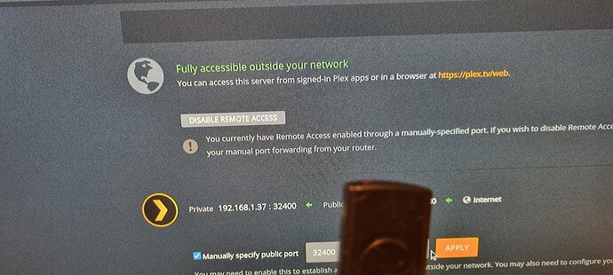

So when i try to access my plex out side my network i get that the server is not available.
When going to settings on the server remote access is green saing server is fully acceseble outside the network.
Version 1.24.5.5173

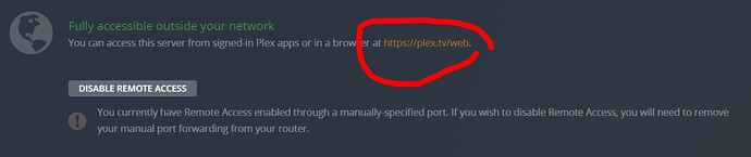

Fully accessible outside your network
You can access this server from signed-in Plex apps or in a browser at https://plex.tv/web.
So what I found was…
  • When using the default port 32400 the remote access status would come and go. But never work.
  • Switching to a custom port and punching a whole in the firewall fixes the remote access status from coming and going.

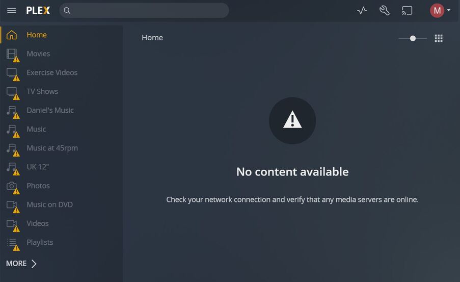

  • https://plex.tv/web link does not work any more. it will always return “no content available” but if I use the external IP and custom port (Public 73.xxx.xxx.xxx : 11xxx ) then I can access Plex.

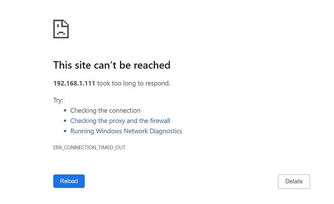

  • Also trying to access the server inside my network via the servers IP http://192.xxx.x.xxx:32400/ no longer works.
If you can access from outside but not from inside,.
  1. Firewall.
  2. Default adapter (preferred network adapter in Plex settings too)

Please do the following:
  1. Verify DEBUG logging enabled, VERBOSE is disabled (Settings - Server - General - Show Advanced). SAVE if you make changes.
  2. Restart Plex
  3. Wait 2 minutes for the server to start and setup Remote Access (the reachability test)
  4. Download the logs ZIP file
  5. Attach it here please for me to review.

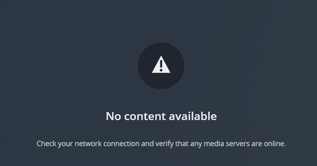

  1. The redirect link called out in the "remote access settings does not work.
    It can’t see the server even though it is accessible
Using the public address and custom external port works 73.xxx.xxx.xxx:xxxxx/web/index.html#!/

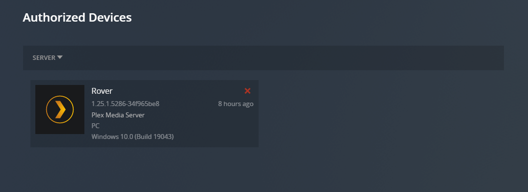

Looking at this image
https://global.discourse-cdn.com/plex/optimized/4X/c/6/c/c6cc8ab9d4e8924774aa02ed6e0dbb3fd2397552_2_690x422.jpeg
It looks like the server itself is not available. Can you confirm ( Settings - Authorized Devices - Server ) the server hasn’t been duplicated and the browser’s not looking for the wrong instance ? ( It’s a pain but it does happen and is easily cleared )

I can confirm there are no duplicates .
