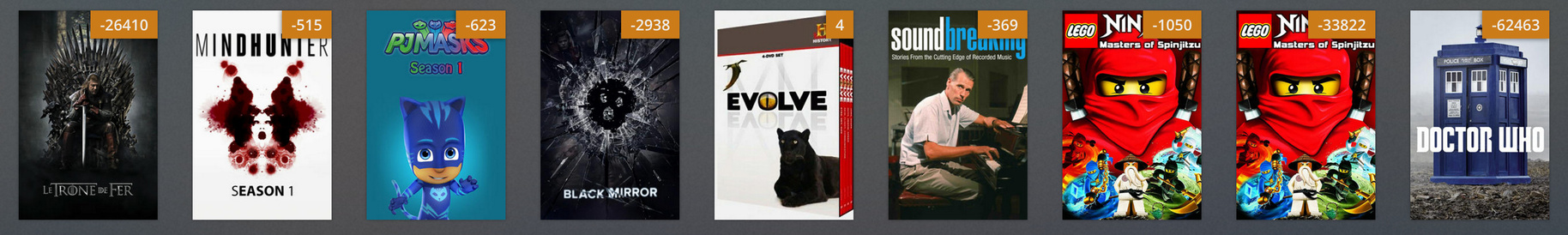

I just switched from my Pi 3 to 3B+ and the problem appeared. I also see some weird numbers in the dashboard (when it works…)

Does this help? I also had the same issue with the unwatched count (amongst other things) and now everything is back to normal
This totally fixed mine! Thanks so much for helping. I ran the command quoted in the linked post, and reboot. Good luck to everyone else.
