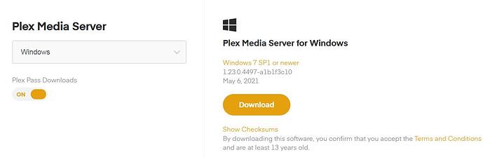

The Plex Media Server download area does not offer beta versions.
The download area provides Plex Pass / Beta versions for logged-in users when the “Plex Pass” option is enabled. It is enabled in that screenshot, and 1.23.0.4497 is the current beta version.
I did not know that! I thought that the Pass button was to enable plex pass on the download. Thanks for be so informative.
Thanks Again
Ahhh, that (mis-)interpretation makes sense too, I follow you. It’s not obvious on the download page that “Plex Pass” == “Beta”.
You can definitely use the non-beta version of PMS with a Plex Pass, if you don’t want to live the crazy beta life.
