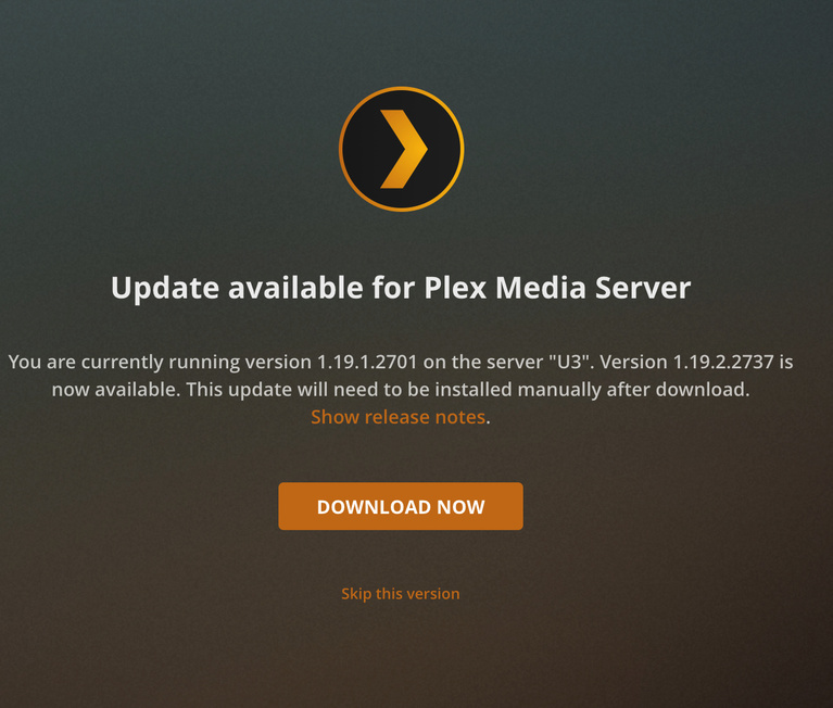

Why use the snap package when native already works? Both will update automatically; both have your metadata in /var/lib/plexmediaserver. The only difference in control is use of the snap executiveversussystemctl`
Plex won’t update automatically on arm64 even with the conventional .deb file because Plex has yet to release an official repository. One still needs to download a new .deb file for each new version.
Anyway this is not what I have asked. I know that the conventional deb package works, I am interested to make it work on a snap :slight_smile: (Also, snap still uses systemctl like any other service on linux :wink: )
The fact that APPARMOR denies it, means that the snap package has not been configured correctly during the compilation. I just thought that reporting it here would be beneficial for future release :slight_smile:
This is not accurate. When you install the PMS package, a repository is added under /etc/apt/sources.list.d/plexmediaserver.list. If you edit this file, uncomment the repository, and add the signing key (the command is listed in the file) you can update PMS using the usual method: sudo apt update && sudo apt upgrade -y
I just did this on my Pi 4 running Ubuntu Server 20.04 and it works as expected.

That’s fair. I just wanted to make sure you were aware that there is indeed a Plex-supported method of keeping your arm64 Pi up to date with the native package.
