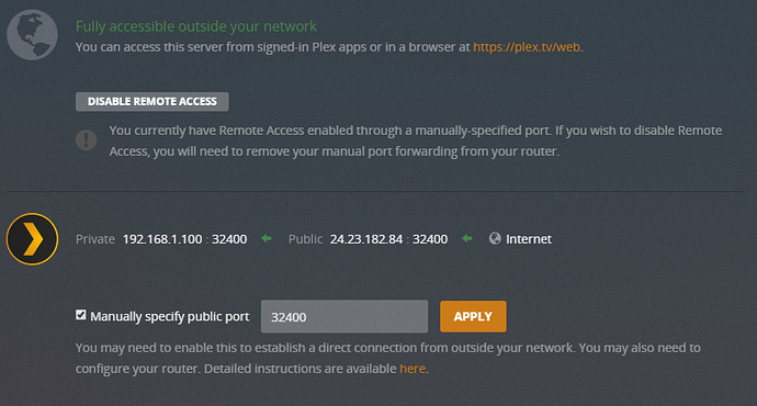

I am having a problem with remote access staying accessible outside my network when forwarding port 32400 on my router to my Plex server or even using UPnP. When specifying a port, it connects for a split second then disconnects and stays disconnected. When using UPnP instead of forwarding port it seems to stay connected longer but also disconnects eventually. I have rebooted router and plex when trying each. Below are my details.
QNAP 251+ Firmware 4.3.3
D-Link DIR-655 Firmware 2.12 Rev B1
Plex Version 3.9.1
Some router screenshots …
When I check manually specify public port and click Apply it briefly shows …
Then a second later shows …

I changed NAT ENDPOINT FILTERING to be Endpoint Independent for TCP rebooted router without effect. Tried changing it to Address Restricted and rebooted router and it is staying connected for the first time ever. That setting looks like it is the same as Port and Address Restricted in that the incoming traffic must match the IP address of the outgoing connection as the manual mentions but the port does not have to match which I guess is what makes it work. Thanks for your help.
The 54.xx.xx.xx incoming connection attempts would not be responses to outgoing request to that IP.
What about this combination
Endpoint Independent for NAT Endpoint Filtering and not enabling SPI?
Ah I see, yeah I replied too soon, while remote access stayed connected longer than it had in past, it eventually lost remote access and when I checked the router log it had dropped the same connection again. Tried disabling SPI and checking Endpoint Independent for TCP and rebooted router it showed remote access momentarily then disconnected. Checked router log and it still showed it dropping connections from 54.xx.xx.xx.
Could it the 5 minute dropping of the port?
Any incoming traffic sent to an open port will be forwarded to the application that opened the port. The port will close if idle for 5 minutes.
Anyway - i believe we are in the right area. is the router up to date with firmware?
Drastic action - resetting the router to factory defaults and recreating the dhcp reservations and port forward
Seeing also what the defaults end up as for SPI and NAT Filtering
Can we disable NAT Filtering as well as SPI
I am going to bed - it is almost 3am
I would not think it would have to do with the 5 minute thing as it connects and disconnects within 1-2 seconds. The router has the latest firmware. I already reset the router to factory defaults and recreated the dhcp reservations and port forward. The defaults are as they appear in following screenshot. I don’t see any option to try and disable NAT filtering but happy to try if you can advise where I can do so when you return. I’ll keep testing and if I figure out anything that works will update thread.
Pages 30 and 31 of the manual i linked earlier mention two similar features - one is Virtual Server and the other Port Forwarding - can you see what you have for Virtual Server - there is also Application Rules which appears to be Port Triggering -which we do not want
So we could try this
Instead of Port Forward setup - you can try Virtual Server setup
Name Plex Media Server
IP Address: 192.168.1.100
Public Port 32400
Private Port 32400
Traffic Type TCP
Schedule Always
Allow All
And delete the port forward and see if it is different behavior with Virtual Server
Other things to check out
On each tab selector in left hand column, go through and see what you have set
Application Rules - we do not want any Port Triggering (so nothing should be here)
Access Control Filters
Inbound Filter
At the end of the day you could ring DLINK support and say it is dropping these packets when i have no NAT End Point Filtering (i,e, set to Endpoint Independent for TCP) and have Enable SPI unticked
You are sure you did this right ? for TCP Endpoint / not UDP
Ok, I feel really dumb! It occurred to me that the router was simply acting like it was not applying the port forward I created so I went and verified the settings and then noticed the unlabeled column containing checkable boxes ( see port forward screenshot in first post) was not checked on the rule I created. That’s right, it was simply not enabled! I clicked the checkbox, saved and rebooted router and it has maintained a remote connection. While the column is unlabled and there is no mention of it in the manual on page 32 I now see a small note about it in the page that loads when one clicks the More … link so that is my bad for not reading it more carefully or just realizing that was what they were for. Thanks for your help, don’t think I would have gotten to this point had you not kept my hopes alive that we could solve this. :slight_smile:
