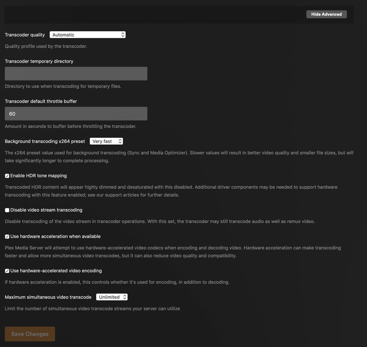

The server is a 2018 Mac Mini with a 6-core i5. It’s a Coffee Lake CPU, with Quick Sync (I5-8500B). Here are the transcoder settings on my server:
Please let me know if I’ve missed something obvious.
