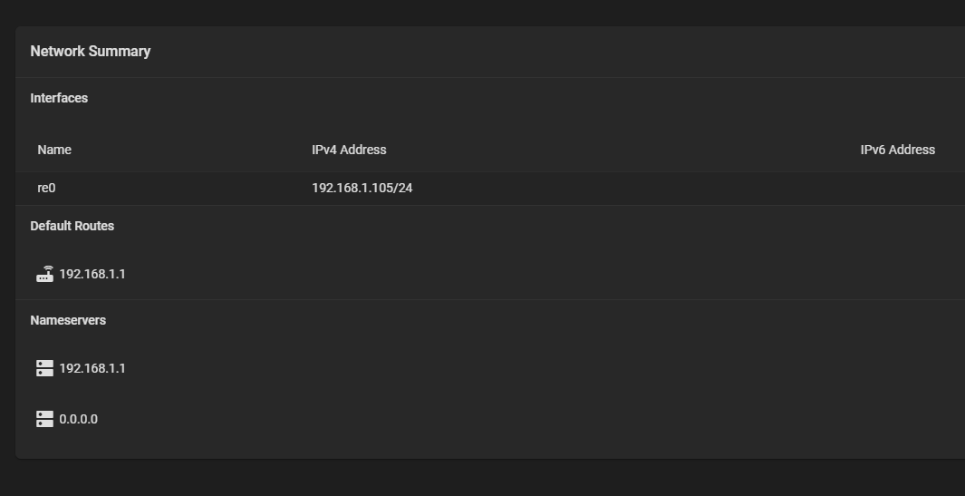

Truenas network summary:
No static routes, dynamic dns (dunno if I should make static etc?) one interface.

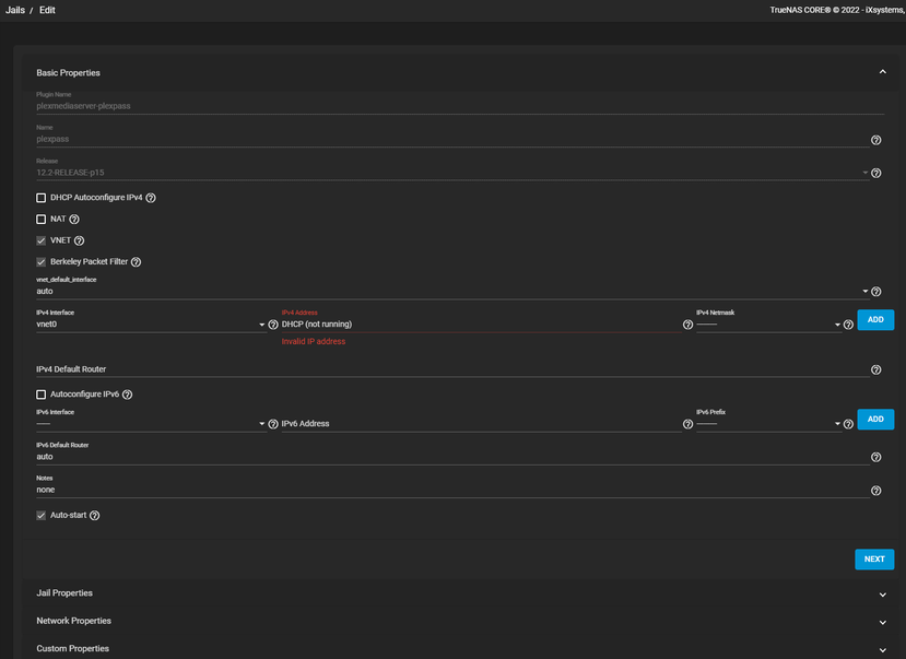

@Conzaaa The network interface of the entire NAS is “re0” but you’re using VNET on the jail. If you check the “ipv4_interface” option do you have an actual item listed as “vnet”? That was one thing about your screen shot on post 13, there were several fields listed as “-----” or “auto” and maybe we’re putting too much faith in the jail to do things fine on its own.
The jail settings seem OK - the jail is getting an address from DHCP, which implies jail connectivity is working.
Plus he can connect to the Plex UI, which also implies it’s working. :slight_smile:

It did, I think I tried that - “vnet0” becomes an option when no DCHP and VNET is selected.
I tried putting 192.168.1.114 (jail IP?) in the IPv4 addrss - and IPv4 netmask as 24, and empty
 then put same in ipv4 in the default router, but no worky. But wonder if I did something wrong.

If you turn off the DHCP Autoconfigure on the jail settings you will want to set up all the info there, including the default gateway, but if DHCP is working for local access there isn’t really a need for that.
