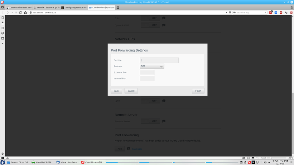

The servers I use–all Western Digital MyCloud PR4100’s–support port forwarding. But I need to know what specific service identifier to specify for mapping, say, 32401 (external) to 32400 (internal). I expect I do not specify HTTP, HTTPS, or SSH. Should I specify PMS? Or something else?
The attached image is of the dialog box for adding a custom port forwarding service. Could you specify for me, please, what to place in each field? Assume I can go to the router and assign a port of my choosing to each server–just not the same for each.
It’s not done in the mycloud settings, it’s done in the router. What router brand do you have? I have 3 different mycloud drives and do what you’re doing fine with 2 Nvidia shields and 2 laptops using 3 network drives. First you need to ensure the network drives all have static ip adresses and the PMS devices as well, which for me are in the LAN Setup section. Then do what @anon18523487 said to do.

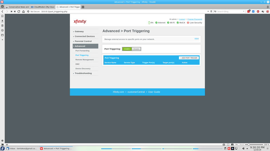

Here is a screenshot of the port triggering intial screen for the router. Now what do I specify, and where?

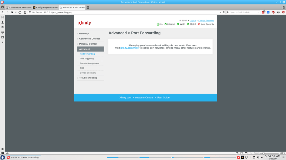

not port triggering, you want the port fowarding section above that.
for each computer you need separate port forward rule. each with a different external port. but all need to use the same internal port (32400) like mentioned by @anon18523487 above

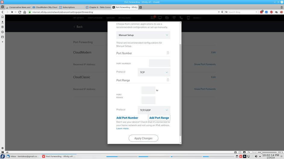

This is what I’m looking at. It looks as though I must specify one port only, and it must be different for each device. Which means I’m stuck, I guess–unless someone here has misinterpreted what port triggering is all about–maybe Xfinity has that weird name for the kind of port forwarding you’re talking about.
The last screenshot I supplied shows Xfinity’s “Xfi” service. Once I start using that, that supersedes the traditional port-forwarding screen that lets you specify incoming and private ports, or internal and external ports, or whatever they call them.

The only issue I have is that after using their Xfinity Xfi app just once, the Port Forwarding screen now looks like this:
But of course that’s crippling. I’ve already shared the Xfi screen, that lets you specify only one port, that is supposed to be the internal and the external port.

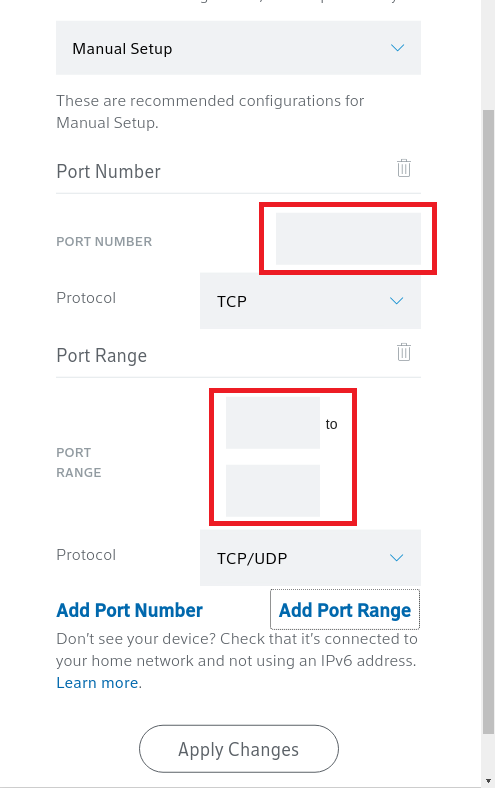

1st pic for me is assigning the IP address I want each device to have. Ex: 192.168.1.11, 192.168.1.12 & 192.168.1.13
2nd pic is setting up the port forwarding using the static IP for each NAS. The Internal port will be 32400 for each NAS. The External port for the 1st NAS will be the same 32400, 2nd NAS 32401 and 3rd NAS 32402
3rd pic is setting up Remote Access within PLEX
What’s at the top of that port forwarding page? Does it have the IP address of your NAS devices? It looks like you pick the device, then set the ports.
It looks like you can enter different external and internal ports. You just need to create 3 different rules. One for each NAS with the appropriate ports.
Don’t conflate the display I see (see my last reply, not that of @Busaman_Va) with what @Busaman_VA sees in his. My display shows only one thing: a blurb for Xfinity/Comcast’s new Web-based app, Xfinity Xfi. Now if you go to another message I sent earlier, you will see that the Xfinity Xfi display specifies one, and only one, port (or a port range), that serves for internal and external, both. That means they will be both the same.
If I don’t get any other answers, I am going to take the drastic step of reverting my router–actually they call it a “gateway”–to factory defaults. That will mean making a written table of my password, every MAC address and existing IP that I want to make static, and my WLAN SSIDs and passwords. Because I’m going to have to sacrifice all of them to get rid of that execrable Xfinity Xfi display, that has hijacked a key function of the gateway and prevents my setting up port forwarding properly.
These look like you can enter different values here.
