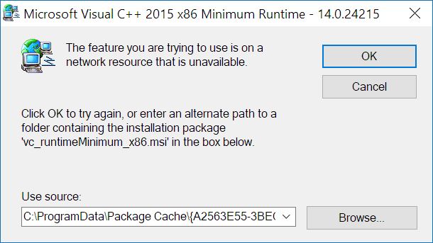

I’m trying to install, for the first time, Plex Media Server. I’m using the latest install file from the download page. I’m running Windows 10 which is fully up to date.

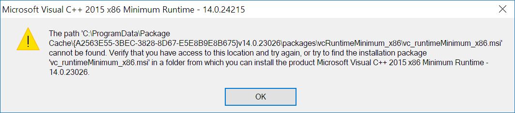

During installation I’m met with “Setup Failed - 0x80070643 - Fatal error during installation”.
Prior to this a pop up for Microsoft Visual C++ x86 Minimum Runtime - 14.0.24215 appears and states that the “The feature you are trying to use is on a network resource that is unavailable”. It gives me the option to click Ok to try again, which doesn’t work. Or select a file in explorer.
I have run the Microsoft Install/Uninstall fix utility, which was successful however after a restart it still will not work.
I’m at a loss with this. I have checked other posts and Googled the issue to no avail.
Any help us much appreciated.

[01CC:227C][2018-11-17T17:28:49]e000: Error 0x80070643: Process returned error: 0x643
[01CC:227C][2018-11-17T17:28:49]e000: Error 0x80070643: Failed to execute EXE package.
[3BD4:3BD8][2018-11-17T17:28:49]e000: Error 0x80070643: Failed to configure per-machine EXE package.
[3BD4:3BD8][2018-11-17T17:28:49]i319: Applied execute package: vcredist, result: 0x80070643, restart: None
[3BD4:3BD8][2018-11-17T17:28:49]e000: Error 0x80070643: Failed to execute EXE package.
[01CC:227C][2018-11-17T17:28:49]i351: Removing cached package: vcredist, from path: C:\ProgramData\Package Cache\72211BD2E7DFC91EA7C8FAC549C49C0543BA791B\
[01CC:227C][2018-11-17T17:28:49]i326: Removed dependency: {6d7fe5a0-cecb-4bb9-88f0-fef90aa02f9a} on package provider: {379E74EF-C9E3-4524-8DD8-11DB443FB6F0}, package pmsshutdown
[01CC:227C][2018-11-17T17:28:49]i301: Applying rollback package: pmsshutdown, action: Uninstall, path: (null), arguments: ' ARPSYSTEMCOMPONENT="1" MSIFASTINSTALL="7" INSTALLLOCATION="C:\Program Files (x86)\Plex\Plex Media Server"'
[3BD4:3BD8][2018-11-17T17:28:50]i319: Applied rollback package: pmsshutdown, result: 0x0, restart: None
[01CC:227C][2018-11-17T17:28:50]i329: Removed package dependency provider: {379E74EF-C9E3-4524-8DD8-11DB443FB6F0}, package: pmsshutdown
[01CC:227C][2018-11-17T17:28:50]i351: Removing cached package: pmsshutdown, from path: C:\ProgramData\Package Cache\{379E74EF-C9E3-4524-8DD8-11DB443FB6F0}v1.13.9456\
[01CC:227C][2018-11-17T17:28:50]i372: Session end, registration key: SOFTWARE\Microsoft\Windows\CurrentVersion\Uninstall\{6d7fe5a0-cecb-4bb9-88f0-fef90aa02f9a}, resume: None, restart: None, disable resume: No
[01CC:227C][2018-11-17T17:28:50]i330: Removed bundle dependency provider: {6d7fe5a0-cecb-4bb9-88f0-fef90aa02f9a}
[01CC:227C][2018-11-17T17:28:50]i352: Removing cached bundle: {6d7fe5a0-cecb-4bb9-88f0-fef90aa02f9a}, from path: C:\ProgramData\Package Cache\{6d7fe5a0-cecb-4bb9-88f0-fef90aa02f9a}\
[01CC:227C][2018-11-17T17:28:50]i371: Updating session, registration key: SOFTWARE\Microsoft\Windows\CurrentVersion\Uninstall\{6d7fe5a0-cecb-4bb9-88f0-fef90aa02f9a}, resume: None, restart initiated: No, disable resume: No
[3BD4:3BD8][2018-11-17T17:28:50]i399: Apply complete, result: 0x80070643, restart: None, ba requested restart:  No
Copy the plex installer .exe to the desktop of the computer onto which you are trying to install it.
Thank you but unfortunately this still didn’t work.
Here are the windows I am getting:
1
Download the installation .exe again. Use this time a different web browser or a download manager software.
After the download is finished, verify its integrity by right-clicking on it,
‘Properties’ - ‘Digital Signatures’ - ‘Details’
It should display ‘The digital signature is valid’
Take a look into your ‘Apps’ control panel.
If tere is already a version of the ‘Microsoft Visual C++ 2015 x86’ runtime installed,
deinstall it and reboot windows.
Then try the installation of Plex again.
