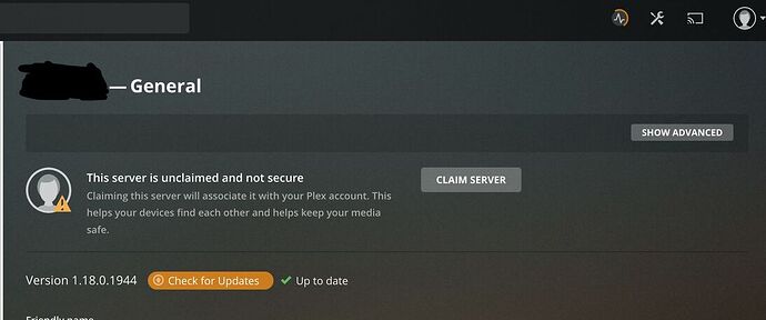

First, I had to switch from HTTPS to HTTP visiting the Plex Server via the Browser. HTTP://192.168…:32400:/web not HTTPS://192.168… which all of my bookmarks are.
Then I was welcomed with a “Finish Setup” Button
which I clicked.
I had to sign in, which I did:
and then claimed the Server:

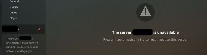

After some clicking to check what settings might have changed,
the Server vanished again:
I closed the Browser, and opened the Plex-Server via my bookmarked HTTPS://192.168… Link
Now, it seems to work again…

Thats rebooting the Router, which I not mentioned I did, but I did. Dunno, if that helped or not. There is no indication why it suddenly worked.
What do you mean by that?
And yes, the connection is flaky, I sometimes have issues on connecting to the local server from a Plex Kodi Addon or Plex iPhone App. Even the Plex.app on my Mac. I need to wait some seconds or minutes, then the server is available again. Only on a Samsung TV it always works and has no connection issues.
I have set up several Plex Servers on several places of my friends and all those connections are flaky. The ppl. use mostly a FritzBox as a router/modem and there seems nothing wrong with it.
My bet would be, if I turn all security settings off, it’ll work better… but that cannot happen.
Ok, never say never…
It happened as I said. Disabling or loosen all the security features in Plex and its clients helped to not getting problems with connectivity anymore…
Anyways, I’ve now read all the (really good, informative and userfriendly written) pages about security, secure server connections, network settings, double NAT, troubleshooting remote access, etc. Those documents all helped me to understand Plex in the way it likes to live in my network and helped me to verify all my settings are correct).

You need be careful what you sign out.
  1. If you sign out the server from your account, you will need to claim it again to reassociate it.
  2. if you sign out your Plex/Web browser app, you only need sign it back in.
The URL used matters based on the situation:
  1. http://LAN.IP.of.server:32400/web will work regardless when you’re home
  2. http://app.plex.tv/deskstop works when away and everything is associated with your account.
Subsequent to this are the security settings (Settings - Server - Network)
If your home is wired or using secure wifi (all modern wifi does have an encrypted SSID), It’s ok to use “Preferred”. It will try HTTPS immediately but fall back to HTTP if it can’t get connected. Some NAS boxes must start with HTTP.
When using Preferred, once Plex/Web and PMS find each other, the connection will upgrade itself automatically to secure internally even though the browser does not indicate it.
This connection was opened with http:// but went secure by itself.
