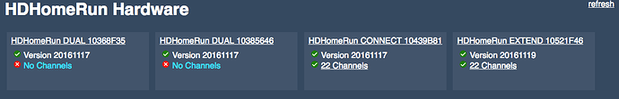

This is the only setup/config program for Mac OSX:
tiff format didn’t upload well.
I don’t use a Mac normally. Just pulled out a MacBook Pro my son uses and see the issue. Hovering on the link under my Dual on the my.hdhomerun.com site says to configure the device on a Windows computer. Might have to have one of the Plex Employees give their advice.
