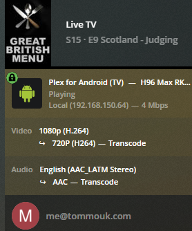

sorry i misunderstood. the option above convert all recordings is a post script not as its being played i didnāt know myself tbh, but encoding a live stream is possible as this is my work around at them moment as forcing 720 4MB works flawlessly

my device can play ACC perfectly fine. it even transcodes the SD live TV channels to that format and standard defination works flawlessly
when i force 4MB
Trancodes to ACC and it again works fine

I just downloaded the official HD homerun app on the same device
So in theory if Plex was using direct play the stream is untouched so the app would also crash can we agree that this would be the case, if my crappy Android box was the problem i would also experience the exact same issue using this app on the same device watching the same channel!
hazard a guess 1080 HD live TV and passing through advents without any issue.
Is this a simple case that the version of ffmpeg that is installed with andriod TV boxes has the issue as discribed in some of thee ffmeg forums with the ACC_LATM codec.
Ok further testing.
The home run App does work but has similar symptoms. after about 30 minutes the box picture freezes so does the audio for about a second and then fails but the app does recover and carrys on playing for a further 30 minutes and repeat. Now then, I think this is 39MB.
so currently I have plex use 20MB as the internal maximum for LAN. and everything plays beautify but Live TV disregards this maximum.
Can this be forced for Live TV it should not be ignoring it for live TV if the client is saying my maximuim is 20 and the server is just ignoring this and passing 39MB. then Server fault righht!!
