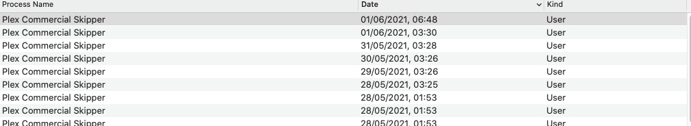

Since version 1.23.1.4602 and prior version, the Plex server has been crashing. I’m on Catalina 10.15.7.
Crash reports
Plex Media Server Logs_2021-05-29_12-36-06.zip (3.7 MB)
Crashed again
Plex Media Server Logs_2021-05-30_10-32-12.zip (3.5 MB)
Each scheduled task session it crashes.
Plex Media Server Logs_2021-05-31_10-24-10.zip (3.9 MB)

@drzoidberg33 Interestingly, I had another complete crash this morning at 6:48am

Yes, it looks like a badly encoded file that keeps causing the same issue.
You could remove the file from your library to workaround this for now. It keeps happening with the same A Bigger Splash (2015).ts file, probably some corrupted stream from a DVR recording.

Nope. But the logs have that file as the last one before crash. Plus logs are dumped in the offending folder of the file.
