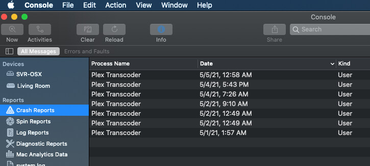

I too, am having transcoder crash at least 2-3 times per day with the same error in console: EXC_BAD_ACCESS (SIGSEGV) this has been happening for the last 2-3 beta updates.

This is the past 6 days, and my server continues to crash(not just during maintenance).
Screen Shot 2021-05-11 at 7.38.48 AM
