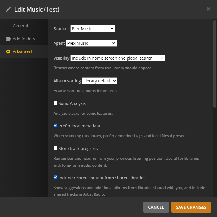

Settings > Server > Library > Group albums by type: enabled

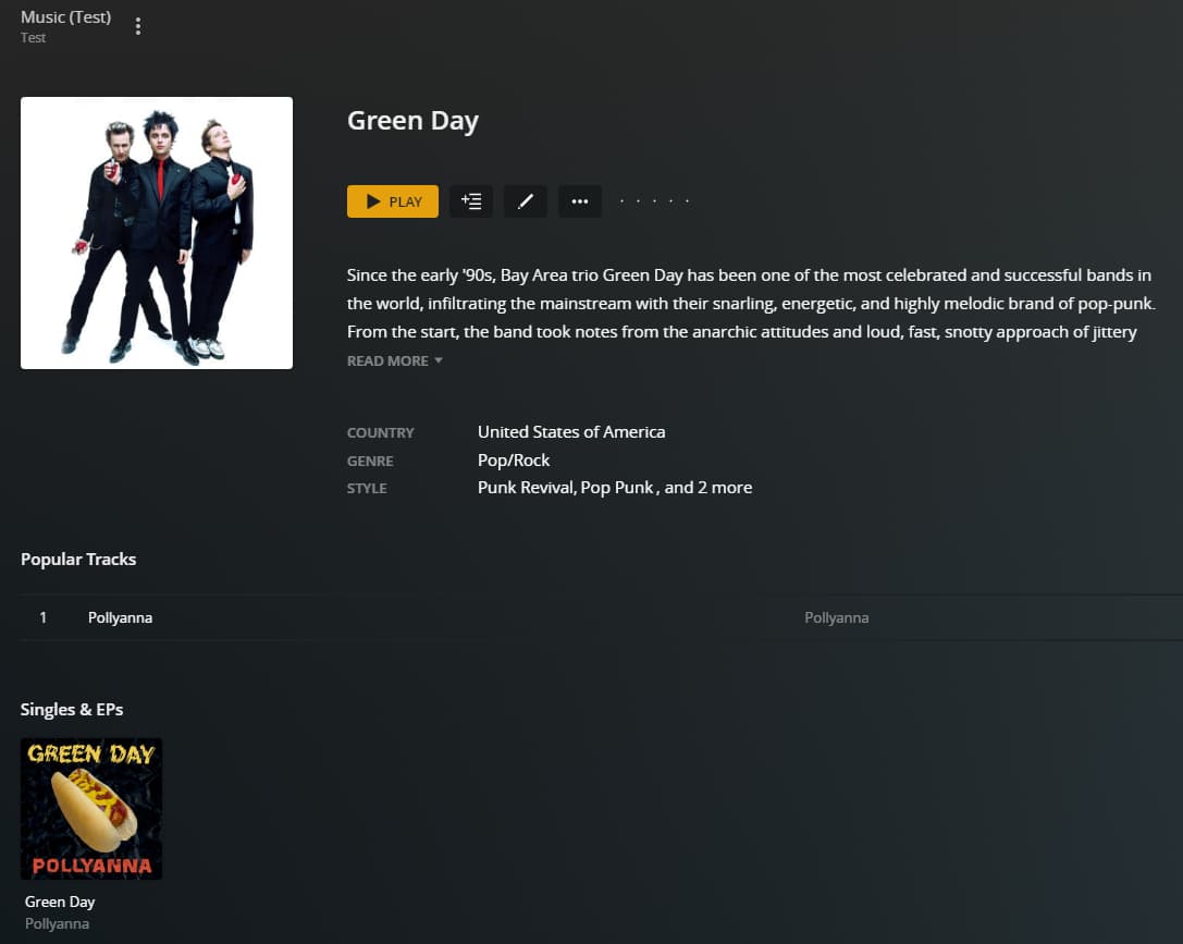

To double check Plex is using the embedded tag instead of online metadata, I changed the “Release Type” to other and it no longer showed up as a single.
Disabling “Prefer local metadata” also automatically changes it to a single despite the embedded tag being other, so that is also working properly.
Gold star @SwiftPanda16 , that was it. I was to focused on the library settings and didn’t recheck my global server settings which has the group by disabled.
