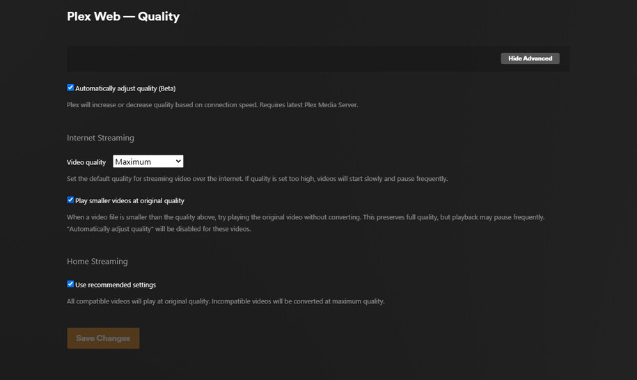

Your Streaming settings.
Video Quality is what you need to explore
I’m 100% certain this is not a quality settings issue but a networking issue but here’s what it looks like anyway
I would try backing off from Max and yes i know you have better bandwidth.
This is at Client and Server
Right but that’s just the default quality. As I mentioned earlier I’ll switch to convert automatically and it drops to 2mbps. On the Plex for windows app there is no convert automatically options but picking anything higher than SD results in buffering, so it seems pretty clear that for some reason the speeds are limited to around 2mbps.

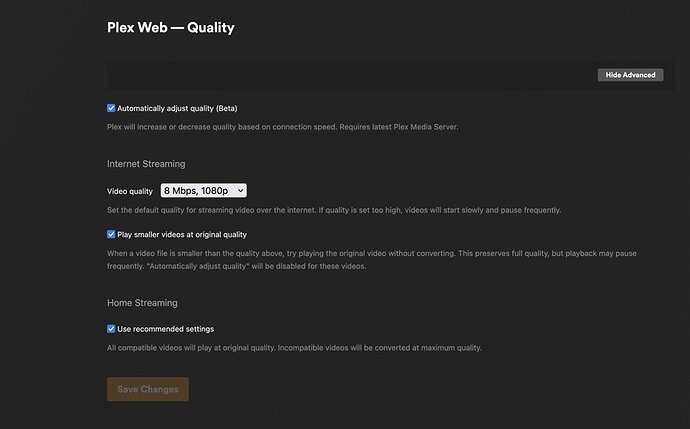

By this do you mean whether the quality settings are higher? If so, yes, I’ll try original quality but that never stops buffering as most of my content is like 16-20 mbps. Switching to convert automatically is what brings me to really bad speeds, it’ll go anywhere from 0.2 mbps to 4 mbps but tends to stabilize around 2mbps.
Based on the iperf results I’m starting to believe it has to do with ISP peering which I won’t have any control over. :pensive:
Don’t set “automatic”.
Do this as a controlled test.
Start at 8 Mbps. See what you get.
From there, go up or down a step
