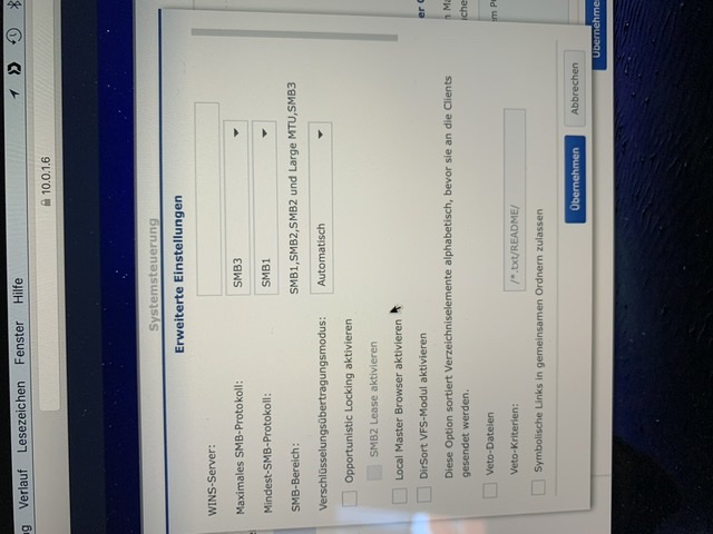

@DKUSER
you must disable Opportunistic Locking in SMB advanced settings. Tipp from the Nvidia Forum.
Had the same issue, now starts prompt. Bild
Thanks, that worked :slight_smile:
Works like a charm now :smiley:
