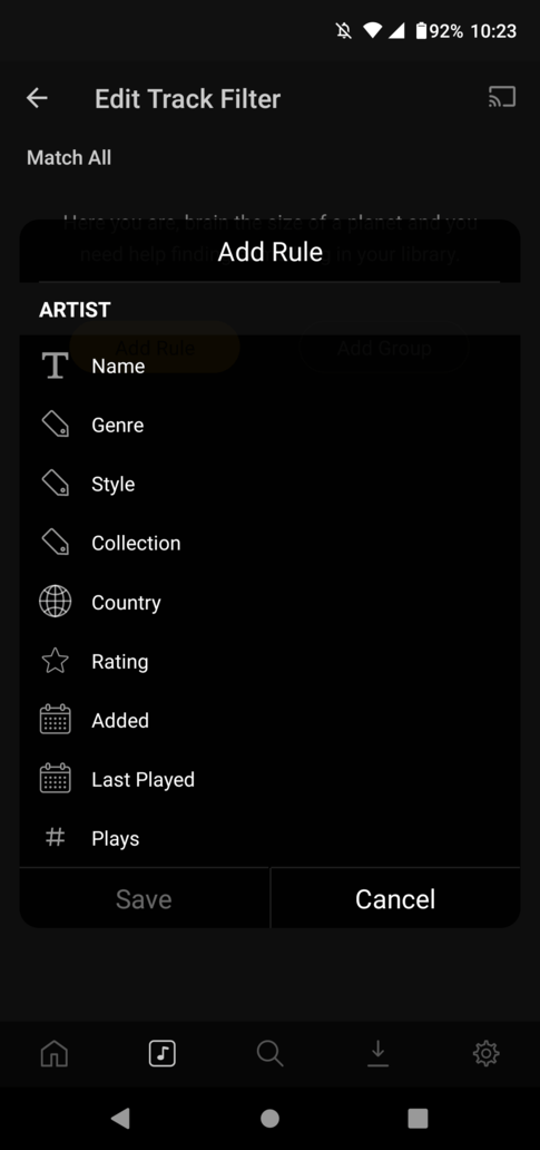

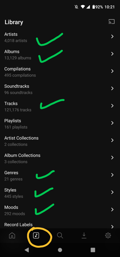

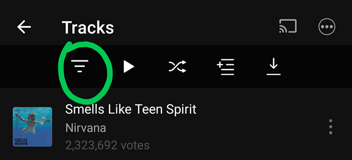

You can currently only CREATE them in any of the categories with green check marks. Just find the 3-line icon which symbolizes FILTER. You can’t EDIT them, unless you’re on the web UI.

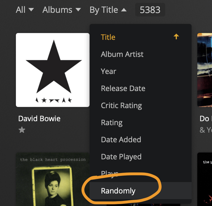

Quick workaround—in Plexamp, save the playlist sorted by random. Should work in web too.
Uh, how exactly do I do that? The only random I see on the web is the Shuffle button.
That option only seems to exist for Artist and Albums. When I select Tracks the whole By selector disappears.

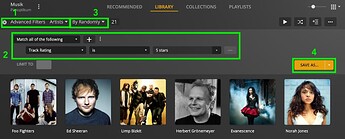

Example: create an advanced filter (1) with some track-based filter criteria (2); configure it to sort randomly (3); save as regular/smart playlist (4).
Similarly in Plexamp (as pointed out be elan): filter the tracks to your liking (1) and select the view’s order to be random (2); then save the resulting selection and its order as a new playlist (3).

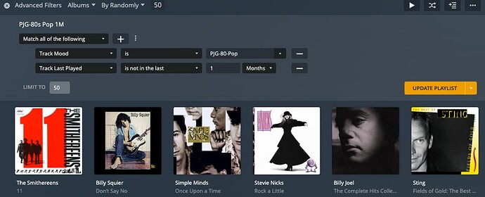

Thought I would contribute and comment on what I have experienced. I am not sure what criteria you are basing your Smart Playlist on, but I am using the Track Mood variable to add my own “tag” to create searchable criteria. Initially I filtered by tracks, then enabled the "Plays column, and sorted by “Plays” so all of the unplayed songs would be at the top. I also added a Track last played filter of 1 month in attempts to keep the playlist fresh once all tracks were greater than zero plays. That worked for the most part, and the playlist on Plexamp mobile would update the playlist periodically as tracks were played and the “track last played” were updated. I decided I would try a different scheme to see how it would work.
My filters are looking for my Track Mood and Track Last Played is not in the last month, as seen in the picture. I decided to sort by Albums, which provides a sort choice of randomly. Even though I chose Albums, only the songs that fit the filters on those albums show up. I keep my limit to 50 tracks as that is several hours of music and keeps the access snappy. Each time I enter the playlist, it is randomized on the fly. When I hit play, it randomizes again before starting. I have a few like this that I have downloaded to my phone, and each time I refresh the downloaded playlist, it pretty much replaces every track with another that is eligible for playing. After playing, I won’t see that song for a month.
Yes, it did take time and effort to tag a lot of tracks but I can now use that tagging for my own use. Maybe you can use some of this info to create some clever dynamic playlists. Looking forward to see what you come up with.
