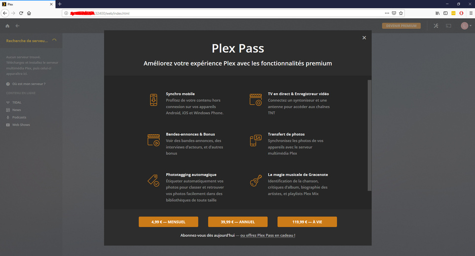

When I install plex media server and connect to the web interface, I see a page that tells me to download plex media server because it can’t find a server, like a client.
Can you help me ?

No, when I first logged in I didn’t get the wizard setup, I come directly to this page

I’m automatically redirected to this.

I am remote because plex is installed on a remote ubuntu server
When I’m local, I get this:
OK my bad, I forgot “/web”. So for setup a plex media server, we have to be in local network.
Thank to both of you
