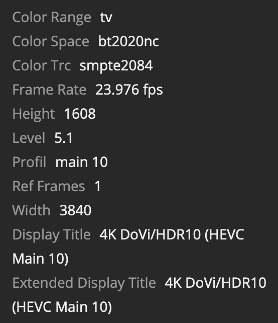

Here is a screenshot of the dashboard of a pink displayed file:
and media info saying:

Bad rip / bad master / seemless branching can cause this too.
I’ve seen it happen.
Researching this, I found one of my own. I re-ripped it (MakeMKV had a problem) to correct it.
Trying out more rips.

And btw the theory that the file is broken is somehow not logic as the file is being perfectly displayed via iOS Plex app or also on the web browser.
So there must be something related to the Plex app on the AFTV.
I did not jump to the conclusion, which you appear to believe I have, the file is broken.
I merely stated.
I then asked…
Clearly, I am still at the investigating / recreating phase.
