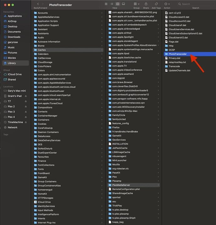

I want you to check the size of the following Folder in your Home Library. Right Click( Get Info) Your will find Home Library in ‘Go Menu’ whilst holding down the ‘Option key’. Looking forward to what you find.
11,192,024,329 bytes (11.59 GB on disk) for 241,089 items
I would be curious what gets recorded in your PMS log when you get this problem, but it sounds like a job for Plex DBRepair based on what SE56 asked. Use it to check/repair your DB and remove old files from the PhotoTranscoder directory the way PMS is designed to do but occasionally fails.

So, to fully understand the procedures, I will follow this link above and do the repair on the Server DB. Also, I will remove ALL which will effectively clear the whole PhotoTranscoder folder.
