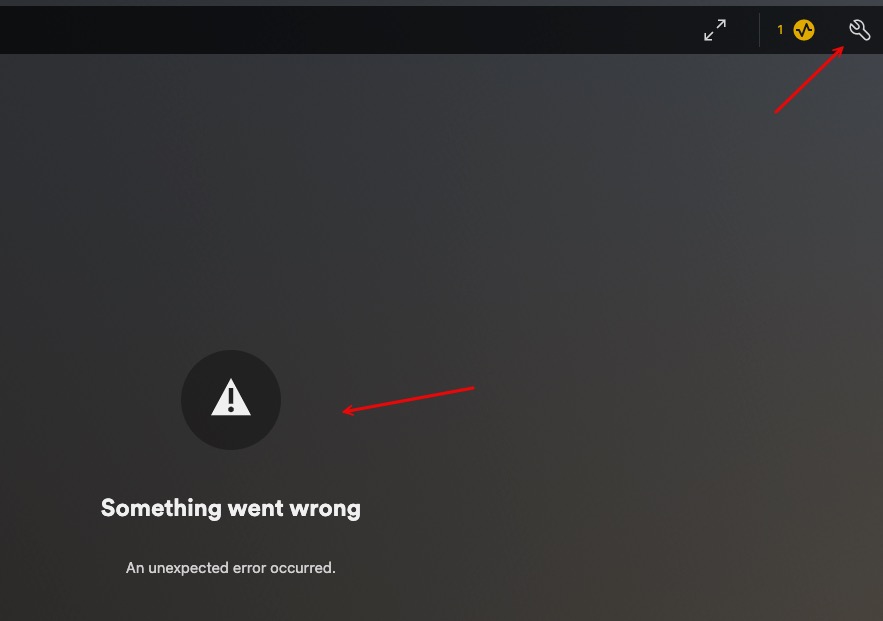

YEAH! Well, this brings us back to the original problem in that all UPDATES since 1.91.0.129 DON’T WORK ON MY MAC STUDIO. I get this…
I have tried and tried to get this to work, but had to rely on the 1.91.0.129 version in order to get passed that error. It appears that there are a LOT of other users having this same error and the codec issue only started days ago. This Something went wrong happened in 1.70-2-384, then worked for those version within the green lines and stopped after that, now including your suggested version1.108.1.307. I sent in an image indicating the working and non-working versions…

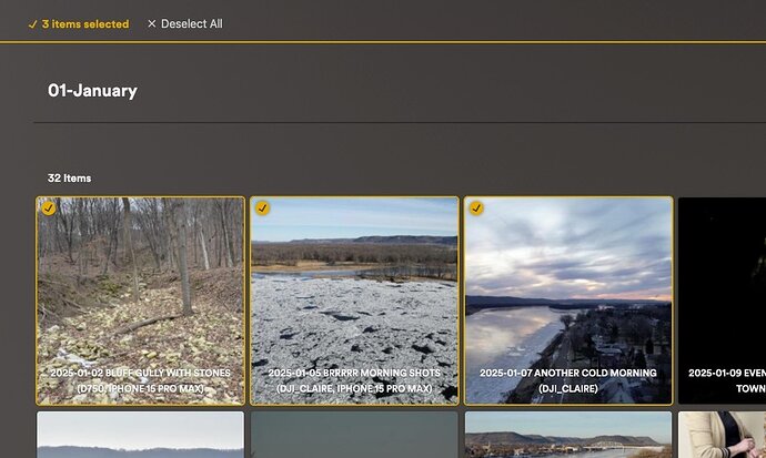

Step 1: I choose the subject of photos which displays the Years.
Step 2: I then select any desired year. This displays that year by month
Step 3: I select the month and get this.

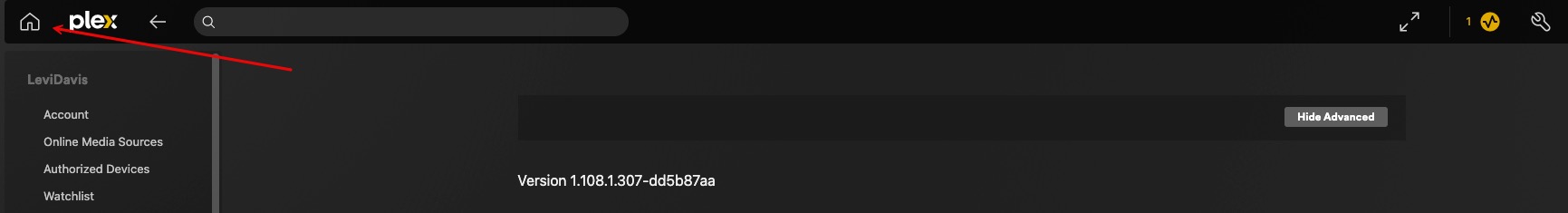

At this point I cannot back out or select any other Subject on the left. However, I can select to go into settings.
Once in here, I CAN go back to home. But now the problem seems to have changed. Now if I drill down to the same month or any other month, I don’t get the error, but get this instead.
