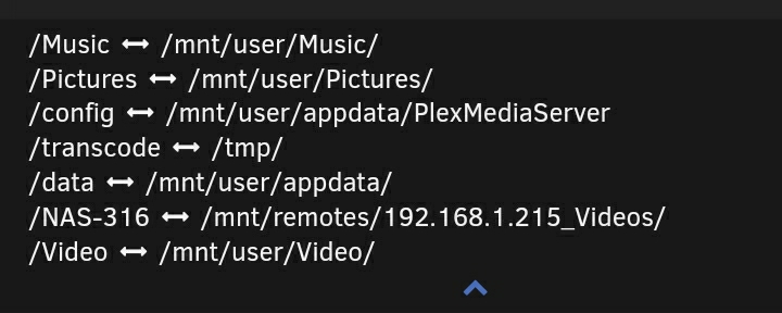

Here is a screenshot of my volume mappings. Be careful though, if you map to a subfolder in /tmp on unraid like I have it you’ll need to have a script create that folder or the docker won’t start on a reboot.

This is what mine looks like. Do your numbers go back down after a scan or does it not fully recover?
After mapping /tmp/ to /tmp/plex/ the container doesn’t expand anymore in the first place. I’d suggest hitting the “Add another Path, Port, Variable, Label or Device” button and configuring it something like this:

The picture shows tmp tmp but you wrote tmp tmp/plex
I have it mounted to /tmp/plex, but that doesn’t mattes specifically. You have your /transcode also mapped straight to /tmp so I reflected that. The important bit is mapping /tmp on the container to something on your host.
