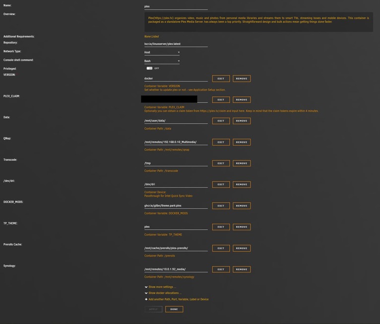

Where did you map the container’s /tmp ? - Container /tmp has not been mapped.
Did you direct map it to your real /tmp ? - No, the real /tmp has been mapped to /transcode
I’ve direct mapped /tmp to the container /transcode for Ram transcoding.
I use following script within the go file of unraid.
mkdir /tmp/PlexRamScratch
chmod -R 777 /tmp/PlexRamScratch
mount -t tmpfs -o size=64g tmpfs /tmp/PlexRamScratch
My docker mappings look are the following:
And then mapped within plex as:
Also making sure I’m describing this correctly (apologies!) it appears the /tmp that the Credit Detection is overflowing is the location within the docker container.

I always leave the transcoder temp at the default.
When in a container on Unraid, /transcode is /mnt/disk1/appdata/transcode
Also, RAM is far more limiting than HDD (space wise).
Remember, /tmp is only 1/2 of the installed RAM.

I do like the idea of just mounting container /tmp into host /tmp/ as it does simplify things. I went ramdisk route as thought it would be a good way to limit Plex’s access to all the host memory.
For your transcoding settings within plex (like below) I’m guessing you set that to /tmp since the direct mapping?
My docker.img is xfs.
Yes,
here are my settings. Please be aware that /tmp/ might be dangerous. As I wrote, 128 GB here, a huge server, and never experienced a problem. But you never know:

In a nutshell, you’ve got media with badly/incorrectly/damaged AAC audio tracks.
The only problems here are:
  1. The media
  2. The entire set of logs filled up within seconds without a clue of which file(s)
Compounding, you seem to have this running in a HDD img file and this IMG file is what’s filling because Credit Detection is never completing / continuously failing from the bad media files ?
Thanks so much for the information and feel slightly dense for not having checked the logs sooner for an actual error. D’oh!
That’s correct I have a SSD Cache drive setup with a 150GB xfs docker img. And exactly seems the bad media causes Credit Detection to never complete/continue to fail and then in turn fills that docker img.
Knowing the issue is self inflected by bad media, you mentioned currently from these logs it’s impossible to tell which piece file it might be.
If I were to turn on the Debug feature than that information would be captured?
Thanks for your time/assistance in getting to the bottom of this!
