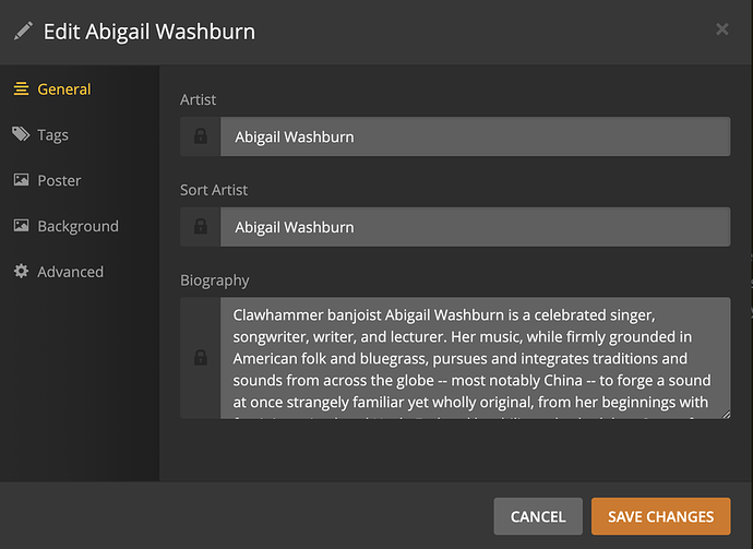

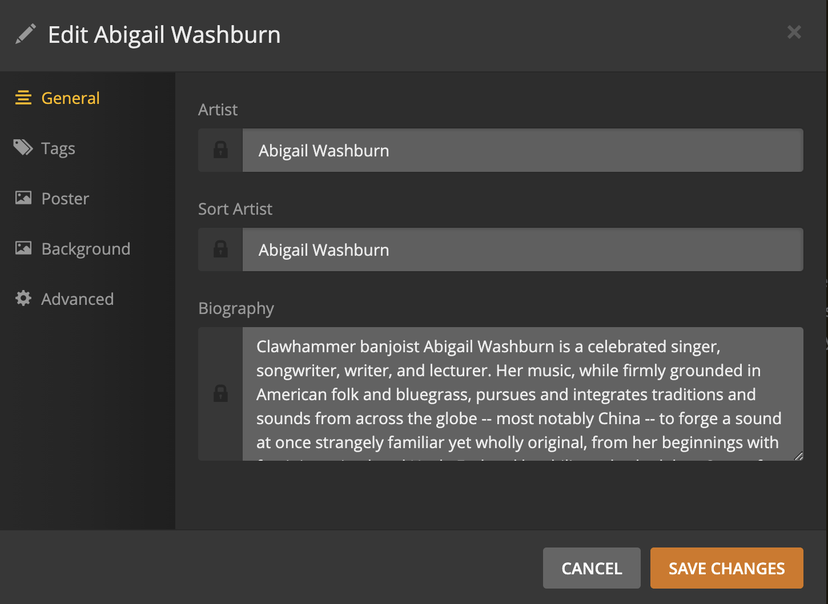

Up to now my library has been sorting relatively sanely, I am careful to tag my files with artists in library sort format, such as moving articles to the end and “Last, First” format for given names. But now it is consistently showing all names in “First Last” format and I’m ready to lose my s**t. Am I really going to have to manually edit 1,200+ artists and lock the tag to fix this? It doesn’t seem to matter whether I use “Prefer Local Metadata” or not. I’m baffled as to why the field would exist and be populated the way it is, if I wanted to sort by the artist tag I would just leave the sort blank.
There is a very large change to how music metadata is handled in the 1.27.0 beta, it might be an oversight from this change but I cannot seem to reproduce the problem on my end.
Could you give me an exact example of the artist or even DM me a sample file?
Here’s an example, showing up at the beginning of the list when she should be near the end.
Ah thanks, I thought you meant for artist names with articles like “The, A, etc”.
The actual issue is that we’re not correctly holding on to the titleSort from embedded tags, I’ve already found the issue and it will be patched before 1.27.0 goes to public.
Thanks for the report!
What I’m talking about is “Sort Artist” should be “Washburn, Abigail” if there is an issue with title sorting I haven’t noticed it yet.
Correct, I’m assuming that’s coming from your file’s tags, which is where the problem is I found.
I’ve tried refreshing metadata both with and without “Prefer local metadata” turned on, neither gets correct sorting. I’d rather leave it turned off since I’m generally happy with the results and don’t want to lock myself out of any new data.
FYI, It’s not simply matching sort artist. It’s ignoring the embedded tags and using it’s own information to populate the “sort artist” data field.
I’m looking forward to this being fixed in the public release of 1.27.0

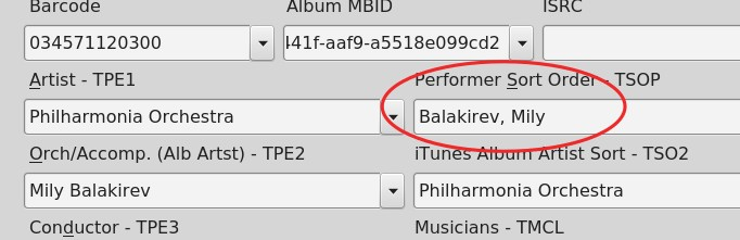

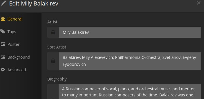

I’ve got this happening again in build 1.27.0.5897. Weird thing is, a few artists are getting it right, but most are not. I allowed Plex to create a whole new library for my classical music, and I found a few that had Sort Artist=Last, First and couple that had obviously gotten the sort order tag from MusicBrainz instead of the embedded tag. For example:
Embedded tags:
Plex found:
What Plex found is exactly what it would have gotten from MusicBrainz.

Doesn’t look like we provide artist sort values at all, so I don’t think that’s coming from Plex. Are you sure it’s not tagged in another attribute in the file?
Could you run ffprobe on the file and post the output?
Aha! You’ve found it. It turns out that Picard has put the artist sort in a tag that I wasn’t aware of, albumartistsort. The few artists that Plex is correctly sorting by last, first are the ones with this tag populated. I’m finding more and more tags where Picard and Puddletag do things differently, and no wonder why they match MusicBrainz. I can clean this up now.

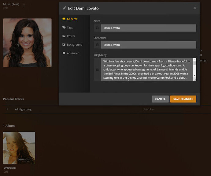

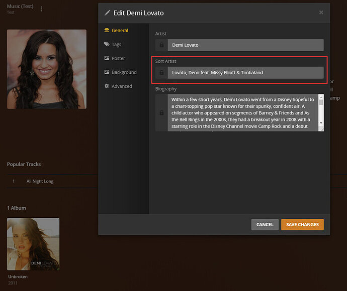

There is still some weirdness going on with the “Sort Artist” for the artist. The “Sort Artist” is coming from the first track’s ARTISTSORT ID3 tag. “Prefer local metadata” is disabled for the library.

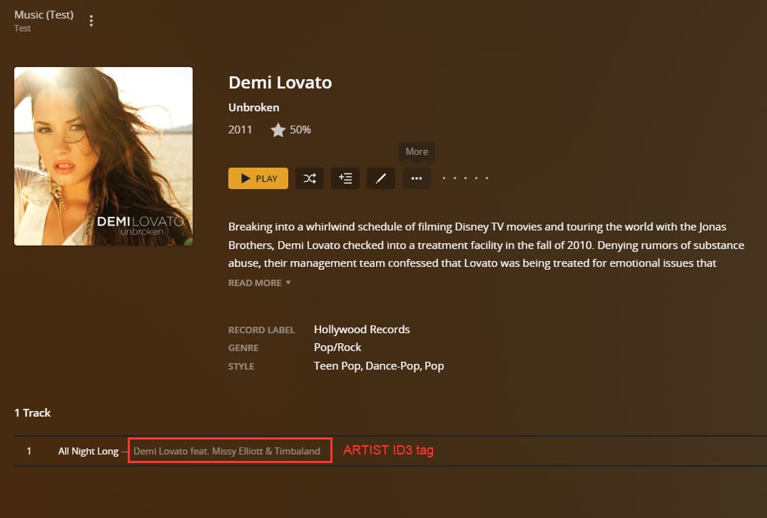

Here is an example. I added a single track to my library that has a featuring artist. After scanning in the file, Plex grabbed the track ARTISTSORT ID3 tag and set it as the “Sort Artist”. This is undesirable because the tag includes the featuring artist.
The file’s ID3 tags:

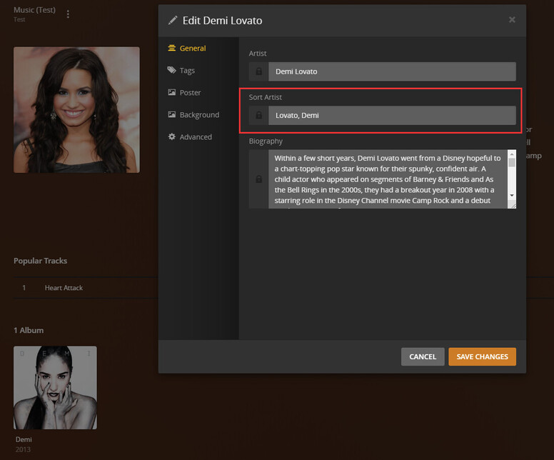

I then removed that file and added a different track to my library. After scanning, emptying trash, and refreshing the artist metadata, the “Sort Artist” updated to match the new track.
I then removed the second track and scanned/emptied trash so the artist is completely removed from my server. Next I tried adding the both tracks one at a time to my library but in different orders. The “Sort Artist” always took the ARTISTSORT tag from whichever track I added first and refreshing the artist metadata will not change it.
Long story short, I don’t want Plex to use the embedded ARTISTSORT tag, especially when it depends on the order files are scanned in and some files contain info like a featuring artist. This was definitely unexpected since I have “Prefer local metadata” unchecked. I would prefer if the “Sort Artist” field just used the “Artist” field without anything coming from the embedded tags.
