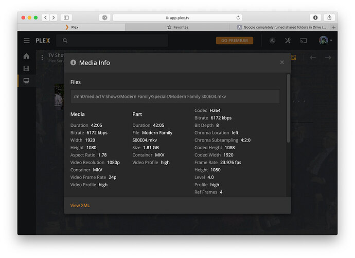

My PMS won’t show metadata for specials for some reason.

The good news:
Plex has scanned and cataloged the file just fine.
The bad news… something gave your Plex the hiccups while trying to lookup the data from TheTVDb.com. It seems Plex couldn’t connect to plex.tv (URL couldn’t be resolved).
  • This might have been some temporary hiccup – what happens if you click refresh metadata for that episode?
  • If that fails… can you reboot the PMS if that resolves the issue (if it doesn’t… try restarting the machine Plex is running on and your Orbi).
  • If all fails… what DNS have you set in your home network?
