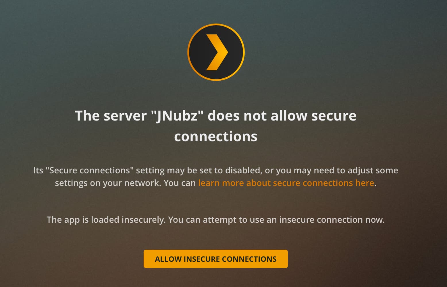

I have this same error and cannot connect to my server inside my private network or on public network. Please reset my SSL Certificate as well. I’ve provided a screenshot of the error o get on another local network Mac when using plex.app. I have secure connections set to Preferred. If I set it to required, Plex.app just says the server is offline.

I have reset your certificate.
I see a very clear pattern in your certificate usage.
About every 48 hours, your server restarts and gets a new certificate
Eventually, Plex.tv decided to stop allowing it.
Therefore, it’s important to make certain this is addressed and doesn’t happen again.
The most common issue is damaged ownership & permissions in /var/lib/plexmediaserver
What’s suggested (adjust to your site configuration) :
cd /var/lib/plexmediaserver
sudo find . -type d -exec chmod 755 {} \;
sudo find . -type f -exec chmod 644 {} \;
sudo chown -r plex:plex .
^^ change the directory and user/group as required.
Now restart PMS
