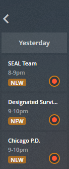

Same issue - got worse with latest update:
Version 1.9.2.4285
Nvidia Shield server
Logs attached.
