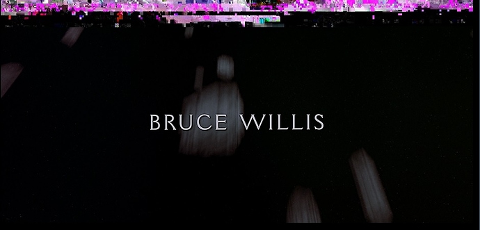

I first noticed I was having issues back in 9.12 and brought up the issue in this thread:
A quick video of the artifacts: https://goo.gl/photos/FQNV8cgR1dTn6Ln79

Is this a Sony Bluray rip?
I have been able to reproduce the same issue, it shouldn’t be related to your server at all. The problem appears to be something caused by the the low number of reference frames in the direct rip from the Bluray. The two files that I have seen that also cause this both of a refFrame of 2. (It also appears to possibly be a problem for the iOS apps)
I actually took this screen shot of one of my Blurays causing the same problem before I realized you link was a video and not just a picture (I used Windows Media Player as it should be the same h264 decoder the Xbox One is using: Just my hunch, but the results are the same):
As for why you can only transcode to 720p my guess would be that the bit rate in the file is too low to be above the cutoff for 1080p. The app’s typically will not transcode to 1080p quality level if the bitrate is below the bitrates for 1080p level.
You should however be able to force a trancode by going to the settings menu (hamburger button) outside of the video playback and disabling direct play and direct stream. This should actually clear the artifacting out as well.
Other options could also be: Manually convert the file with ffmpeg (ffmpeg -i “File name” -vcodec libh264 -acodec copy -scodec copy “File name(2)”), use the server to create an optimized version and the replace the original afterwards. Personally, I don’t like to leave my app forcing everything to transcode so I use ffmpeg to conver the video stream with the above option which clears the artificats out for me.
The movie I showed was the Lego Justice League vs. Bizarro League and it appears to be a Warner Brothers disc. We tried to watch Underworld last night and it is indeed Sony. I remember this happening on Hot Pursuit also. It is a Warner Brothers.

Confirmed on Hotel Transylvania 1 and 2, both Sony films.

Goosebumps (2015) as well - sony.
LEGO Justice League: Attack of the Legion of Doom! (2015) - Warner Bros

The only solution will be to force a transcode of the video stream. The problem that the developers have to work on now is that the only key factor we have seen is the low number of reference frames. And from what you have seen it is a large number of Blurays that are affected.
So the 2nd part of my suggestion involved a way to have the server fallback to direct play if the server cannot transcode. The reason why this is important is that if the profile is updated to simply transcode right away most users who are using a NAS based server will instantly lose the ability to playback any of those movies.
My personal solution was to run these blurays I encountered through ffmpeg to re-encode the movie myself. ffmpeg -i 'in name' -vcodec libx264 -acodec copy -scodec copy 'out name' was the command I used. It does fix the artifact problem and didn’t decrease quality in any noticeable way for me.

For the artifacts it seems to be affecting multiple platforms which means it is affecting multiple h264 decoders. It doesn’t affect all of them, IE I don’t see the artifacts on my Android devices, but I do on the Xbox One. There have also been reports recently of it happening on iOS devices (I don’t have one so I can’t test it out). Which is why it’s getting tricky finding the exact cause because it isn’t just one device having the issue with these rips it’s multiple.
One other thing I thought of you could try is disabling direct streaming from the App settings. This will force the video to transcode whenever the audio transcodes, but shouldn’t change anything if the file direct plays. For my bluray rips I always take the DTS tracks so it should force a video transcode and looking at a few of your media info’s above it looks like you do as well. But because of the 720p problem I would check your server log when trying it to make sure it isn’t transcoding down to low quality format or that could be just as bad as the artifact problem. If you need help looking at the logs to determine it for sure, I have no problem helping. (The reason I am suggesting looking at the logs instead of the settings is so that the video doesn’t get set/stuck to one of the lower quality selections until you guys can get the 720p problem fixed)

Glad the issue has been found. It was driving me nuts. I convert the audio to FLAC when I rip my blu-rays. Is FLAC natively supported on the Xbox One?
Do these blu-rays with with low reference frame counts play alright in the blu-ray player on the Xbox One? I noticed it on TinTin, but my copy is in storage as I ripped it a few years ago.
I think it happened on Interstellar as well, if no one knows the answer I’ll pop that one in as it’s still in the house.
