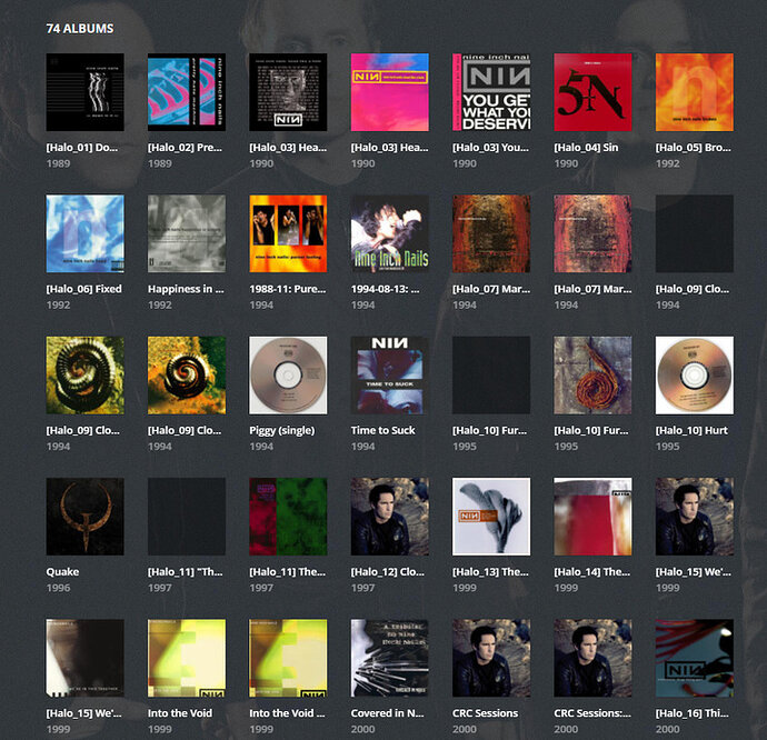

here you can see plex respecting my albums non-standard names (from the tags, I did not modify them manually in plex), while still matching most with musicbrainz and getting the correct art etc.
