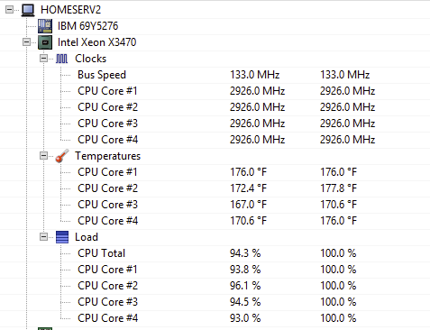

Just blew everything out. There’s a haze in the air. cough cough Got a 90 CFM blower and there’s not a spec of dust left in this thing.
Unfortunately, my prediction that I didn’t state was correct. The stock cooler can’t keep up with sustained CPU load of the higher TDP processor I put in. As transcoding on the fly only spikes the processor, I never get anywhere close to these temps on a normal basis. Feeding a reencode via HB, causes some crazy temps. I’ll need to look into an alternate cooler, or use a different system for reencoding.

I see your comments, but those numbers don’t immediately seem TOO HIGH For a modern CPU when it’s 100% busy.
Why do you think that’s too high?
Here, it’s a different CPU, but he’s cavalier about similar temps.
