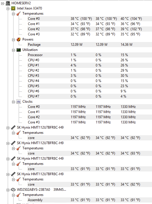

Do any of those tools show other temperatures, especially anything like a socket or TCase temperature?
That sounds hot, but “modern” Xeons ARE hot. I only see TCase limits (72C) published for the X3470 and 1156. I expect a TCase number to be a lot lower than core temp - the outside of the CPU should be a lot cooler than the core of the CPU. I sorta think if you were too hot you’d be getting throttled or shutdown.
I know Xeons shut down Right Now if they think they’re going to cook. Maybe you can find a good way to see if you’re being throttled.
I don’t see any temp gauges for socket or TCase using either temp measurement tool.

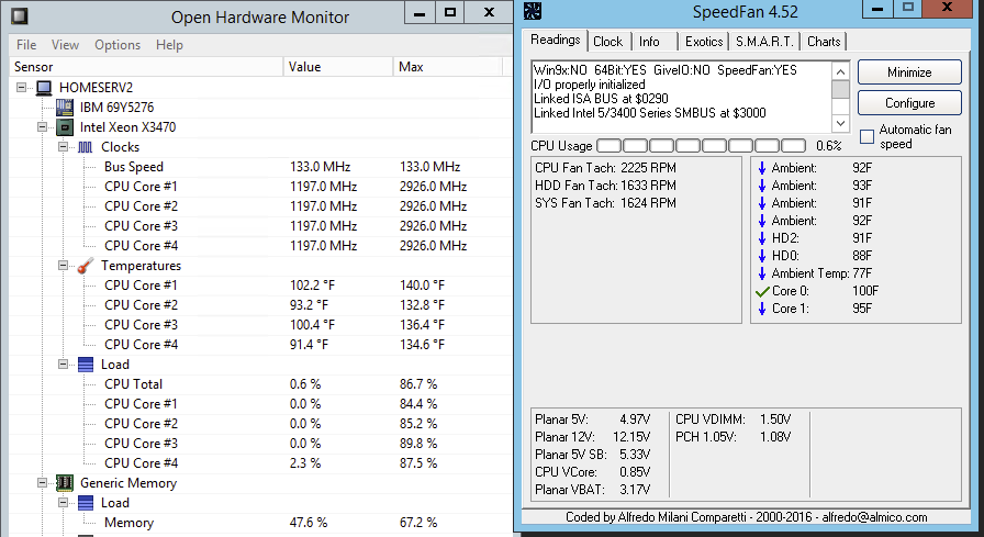

I’ve been running this processor since 2015, but never paid attention to the CPU temp until I happened to check my drive health at the same time as a sustained pegging on the processor, otherwise I would never have known how hot this gets.
Running a HB encode does not instantly spike the temp to those temps, it does take a few minutes to get there. It remains at that temp throughout the rest of the encode. Processor clock speed does not decrease during that time period. That’s the best info I’ve got.
Unless one of those readings is categorized as an ambient temp?
Nope, CPUID’s HWMonitor says those Ambient temps are off the sicks of RAM.
Core Temp says I’ve got a Tj. Max of 210F
I think that’s good - I think that means you’ve got some headroom still.
