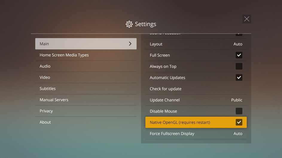

try turning off “Native OpenGL” close and reopen PMP, recheck

hi, thanks for the reply. I already tried that and it’s worse.
