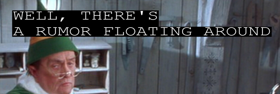

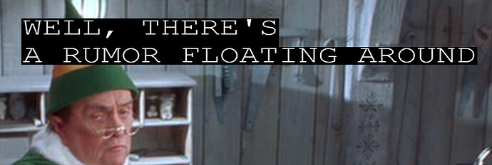

Now that I am learning more about subtitle formats, I am only displaying the SRT subtitle via VLC although the mediainfo shows both. I went back to the DVD and played the video in VLC and can only display one subtitle track called Closed Caption 1.
Displays at the top. This is at 7 min 52 seconds in the video. I am thinking that this is the SRT subtitle but how do I know for sure?
I am now looking for other ways (programs to use) to verify the video file has both subtitles. I thought there was a program I could use to export the VOBSUB subtitle into a separate file. I am trying to find that program.

If I were to use a graphical tool to look at the contents, I’d use MKVToolnix-GUI
This screenshot shows you that Surround 5.1 is the Default audio track and SRT subtitles are the default subtitles when enabled.
Compare this to the text output above. There is a 1-1 correlation.
If I now create a new test version of this, where both sets of subtitles are FORCED, I do not get VOBSUB display
If I try to display this VOBSUB in any form, I do not get it but SRT displays fine.
(Using Celluloid player)
