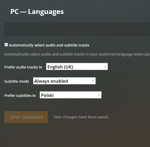

I had a problem with Plex insisting that it could not connect to the server, so I uninstalled it from my PC and Firestick. It is running again but refusing to give me subtitles that used to work perfectly. They are embedded ass or saa subtitles in mkv files. I believe everything is set correctlyImage1 Image2
However on the firestick it says subtitles none and if I hit Settings/Select Subtitles it shows “none” even though there could be both English and Polish subtitles.

I did clear out the contents Plex or Plex Media server folders so that I would have a clean install and of course I have lost any amendments I made.
Although foreign language files a showing up as no Audio but nevertheless playing Subtitles are completely dead
