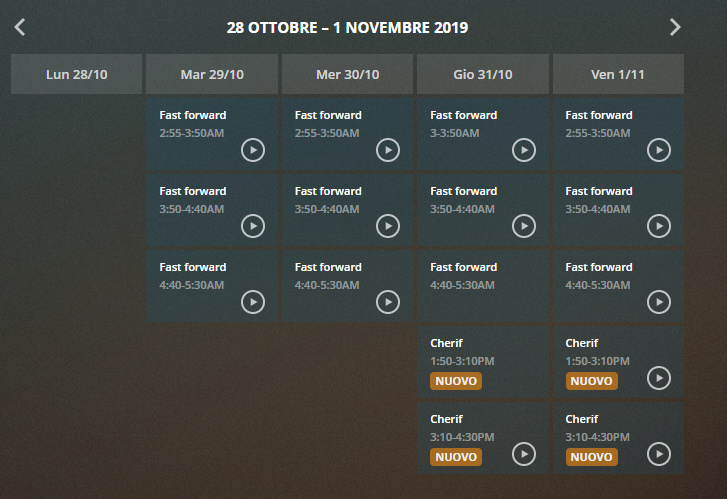

I noticed that the Plex DVR failed 4 recordings in the past days, all of them have in common that Plex report them as “Successfully recorded”, but no file is present in the library nor in the file system.
A. Fast Forward at 4:40 - 5:30AM of the 31/october
B. Cherif at 1:50 - 3:10PM of the 31/october
C. Fast Forward at 2:55 - 3:50AM of the 02/november
D. Fast Forward at 3:50 - 4:40AM of the 03/november

This TV channel aired 3 consecutive episodes, and the DVR was set to record every aired episode of “Fast Forward”, extending the recording duration of 15 minutes. That’s probably why I see this log line:
Nov 03, 2019 04:05:28.450 [14988] DEBUG - DVR:NewSchedule: Scheduled an operation ‘Fast forward - E7 - Il caso Dominik Fiedler’ on channel 038 on tuner 3 between 2019-11-03 03:50:00 and 2019-11-03 04:55:00
The recording of the second episode of the three started 15 minutes late, probably beacuse it waited for the episode before to actually end. I’m not really sure that’s how it’s supposed to work, I would have expected the second episode to start in time, independently from other episodes being recorded at the moment. I’d be glad if that could be clarified, even if it’s not the core of the issue, it seems to me a bug to be addressed.
