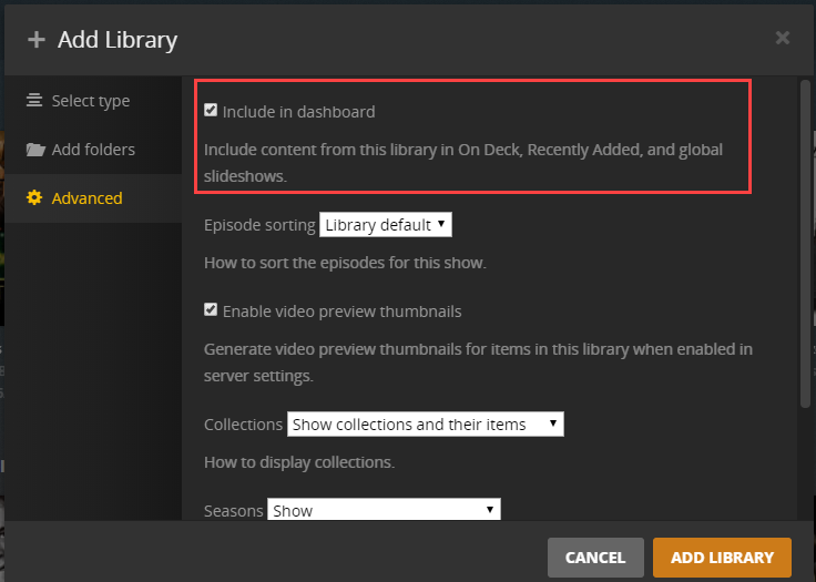

Click + sign beside Libraries
2018-08-27_12-23-09
Select Library Type
Give Library a name, and add folder location on the Add folders tab. Then on Advanced uncheck the include in Dashboard option.
This will allow the shows to be recorded because they do not exist in the recording library. What the other user was then saying is you can add this libraries folder location to your other library so that library will see all new recordings.
