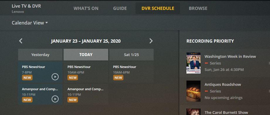

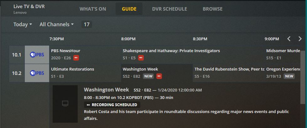

During my fumblings, I have discovered this.
Both of these screen shots are from today Friday 1/24 taken at around 9:30AM.
Notice that Washington Week is flagged as NEW and is showing the red record as being set. in the GUIDE shot.
But in the DVR SCHEDULE shot it is not showing that it will record.

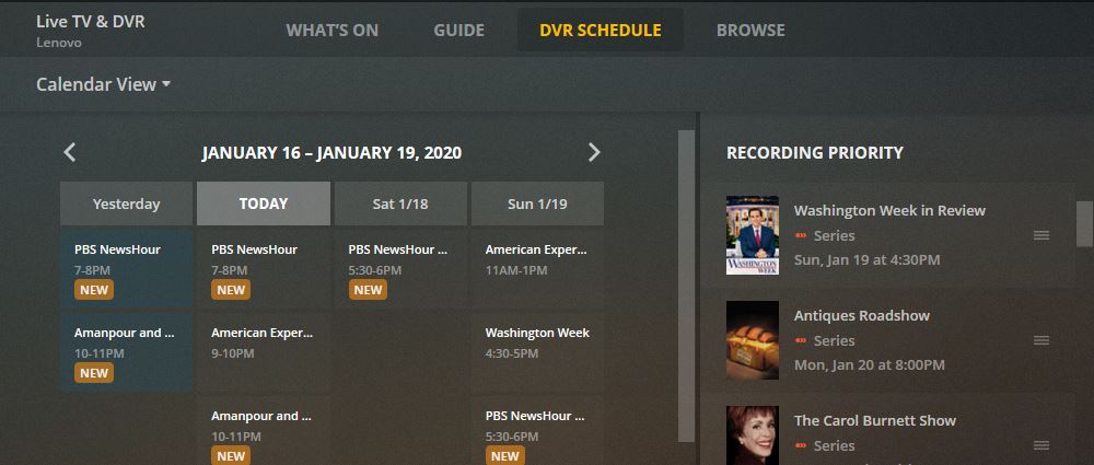

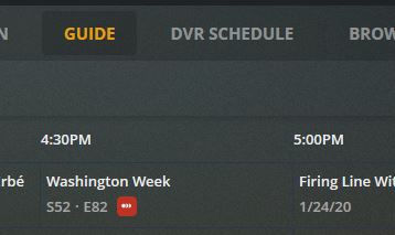

Meanwhile the DVR Schedule shows that Washington Week will record Sunday at 4:30PM.
WW Sunday
And the Guide agrees.
WW Sunday Guide
Let’s see if it does. I think it will since it did last week. Then maybe look at why it didn’t choose the Friday session when it was flagged as new.

About the scheduling, since the program is on two different channels, the NEW and previously aired are conflicting with the previously aired cancelling out the NEW. You would have to go into the recording and set it for New and Repeats, then go into advanced and set “Limit to Channel” and “Limit to Air Time”.
Totally understand what you are saying about the database.
The first time WW was to record was marked new, but it didn’t.
I had it set to “new and repeat”, without limits.
I don’t understand why it has chosen Sunday at 4:30?
Do a full refresh of the guide in case they are pushing out last minute edits.
