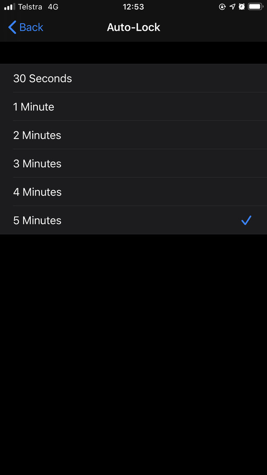

P.S. The reason for my hesitation is, syncing 9000+ songs to a device with MDM and a maximum screen idle time of 5 minutes does not spark joy. Further, if I take a break for any longer than say 20 minutes in the process, the rest of the songs that didn’t come down just fail on future attempts to finish it.
iOS/iPadOS: Settings - Display & Brightness - choices of: 2m, 5m, 10m, 15m, Never
You might just need to turn off the Auto-Lock reloading that many files. 9000 files @ 3 MB average = 27 GB. Assuming 27 GB @ 90 MB/sec (uninterrupted average transfer speed) will take somewhat over 5 minutes to complete. Most devices associate at 877 Mbps which is closer to 80 MB/sec in practice.
The joys theory vs the hell of practice.
MDM I.e. mobile device managed
For security purposes no timeout is disabled due to the corporate profile I have opted in to having on my phone for the joy of email.
  1. Due to Plex transcoding sequentially on my low power NUC and needing to transcode almost everything, it takes about 1.5-3 seconds per song, so let’s put that at an average of 2 seconds, so 18,000 seconds just for the transcode, but that’s ok I let that happen overnight and just don’t open the Plex app. But then “transferring” is more than just a file dump, watching on the dashboard I see every song pass through, and validate which is again about 0.45-1 second per song at least because regardless of my NUC being on a gigabit line with a 970 Evo, and my iPhone being connected via AC right near the router, the sequential, validation aspect kicks in, and it takes about 7500 seconds~ I.e. 2 hours. With a mandatory 5 minute lock screen time out, I trust you to do the math on the amount of taps and attention required
