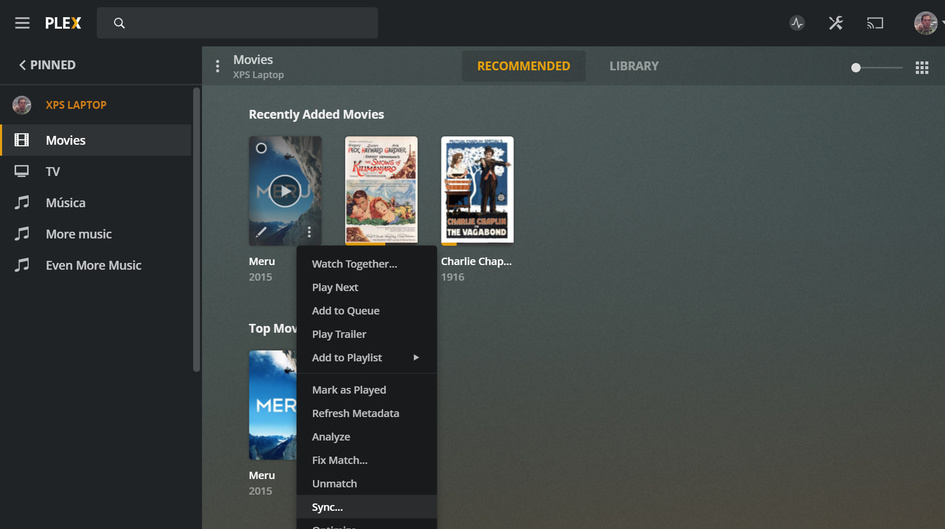

@JamesShaffer @lafreniere.luc Wonder if you can see the Sync option in other clients? Easier one to check is probably Plex Web, can you verify that the option is there if you sign in with the same account that you’re using on your phone?

I’m definitely logged into both my Plex Media Server, Plex Web and Plex Android app on my Slate via my main, admin account.
I looked for the sync option on the web and behold! It was there! I didn’t even know Plex Web could “sync” files somehow. I’ll have to look into that later, interesting.
