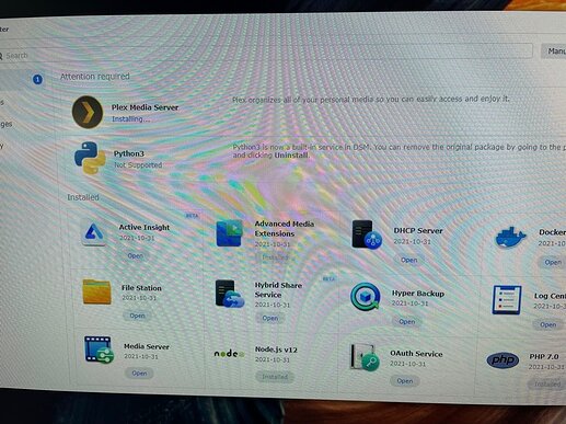

@ChuckPa I ran into a potential snag on the migration. I don’t want to take up @mpalermo73 thread, so can make a new one if that is better. My short list of what I have done so far:
I walked away from the migration and came back to the DSM to see an error popup from the installation that said I needed to re-login to DSM to continue. However, I am still logged in and I confirmed that my timeout is still set to 50,000 minutes. I see this in Package Center with the installation maybe still working:
My migration log currently shows this:
Plex Media Server migration to DSM 7 started: Sun Oct 31 12:02:06 PDT 2021
=== Sun Oct 31 12:02:06 PDT 2021 === Start: Change ownership
=== Sun Oct 31 12:28:51 PDT 2021 === Completed: Change ownership
=== Sun Oct 31 12:28:51 PDT 2021 === Start: Convert symbolic links
=== Sun Oct 31 12:35:48 PDT 2021 === Completed: Convert symbolic links
=== Sun Oct 31 12:35:48 PDT 2021 === Start: Migrate Plex Media Server
DSM will show this error. It’s STUPID.
The idle-time logout has fired and wants you to log out.
If you log out – there is no harm.
You will lose access to watching the popup but it will keep running.
use TaskManager / Resource Monitor – Processes
Wait for “Plex/Migration.log” to show it it’s done Cleaning /volumeX/Plex
You’re at the point where its moving the “Plex Media Server” folder from Plex to its new location in PlexMediaServer/AppData.
This is the critical part.
Let it run and you’ll be OK.
( I wrote the code to “move”. For reasons I don’t understand, DSM 7 will COPY the files one at a time… even on the same volume… which is just DUMB)

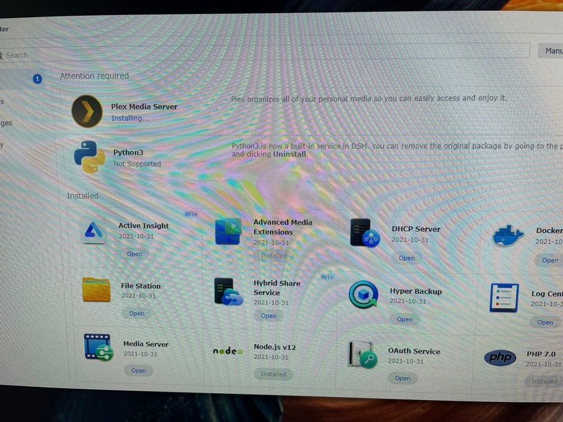

I’m having a similar problem to the others here. One difference, while I read that I would need to set permissions, I missed that I should uninstall Plex before updating to DSM 7. I updated to DSM 7, uninstalled Plex, installed the DSM 7 version of Plex Server, set permissions, uninstalled and installed again. The install took only a couple of seconds and no libraries migrated. I have tried uninstalling, uninstalling with erase option, and even manually deleting the PlexMediaServer shared folder. When I again install, I get no libraries migrated.
By the way, I neither clicked the “Repair” option nor installed from the Synology package store.
Any way to trigger the migration so I don’t lose the status of thousands of files?
Thanks!
