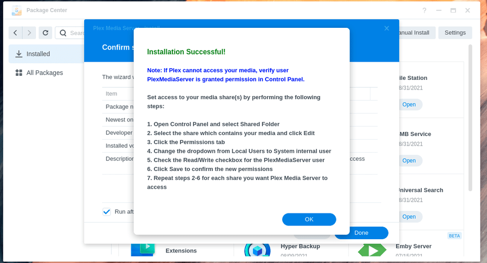

Please let me know if this helps remove ambiguity about whether installation was successful or not without requiring you to read the whole thing?

  1. Create the Plex shared folder
  2. Put everything back into the Library/Application Support/Plex Media Server structure
  3. Remove all of the DSM 7 application (Uninstall + Erase)
  4. Install PMS 1.24.2.4973
  5. It will migrate directly from your backup in the Plex shared folder → PlexMediaServer shared folder.
Check on the Synology - Just like you did when you initially set it up.
