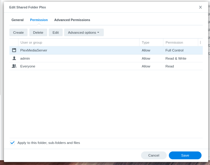

As long as you have a Plex shared folder with
Plex/
  Library/
    Application Support/
      Plex Media Server/
          Cache/
          Codecs/
          Crash Reports/
          Logs/
          Media/
          Metadata/
          Plug-ins/
          Plug-in Support/
          Preferences.xml
Then the migration of the DSM 6 server can occur.
Steps
  1. Uninstall the DSM 7 package using the ERASE option
    This will completely remove the rogue & unwanted DSM 7 installation
  2. Perform a “Scenario 2” migration (because it didn’t occur naturally the first time)
    You will want to begin at Step 4 of Scenario 2 (see the FAQ link below)
  3. As you assign the “Full Control” permissions, permissions MUST be “Apply to this folder, sub-folders and files” else migration will fail or PMS will malfunction later.
  4. Do not be alarmed if it sits at “Installing” for a long time. This is normal and expected.
  5. Do not navigate away from the “Installing” tab in the browser. Open a new session tab to the Syno to look at the Migration log.
  6. It is normal for some Synology systems to claim “Operation Failed” and exit from Package Center . Migration.log will show you current progress and when complete.
  7. The final message in Migration.log will be “Clean /volume1/Plex” . This is where PMS remnants are removed from the “Plex” shared folder.
Note: The installation / Migration script will check several things before it starts.
If it doesn’t like something, it will exit the installation with a popup message.
That message will tell you the error and how to fix it.
After taking the corrective action, you may start the installation again.
Please ask if you have any questions before embarking on this task. It has a lot of moving parts and a lot of data moving around.

The installation-migration code is setup this way:
  1. It looks for Plex/Library/Application Support/Plex Media Server/Preferences.xml
  2. If it finds that AND PlexMediaServer/AppData/Plex Media Server does not exist
  3. Then it will start migration
The migration is only concerned with the contents of Library/Application Support/Plex Media Server (which is the DSM 6 server & metadata)
Anything else in the Plex shared folder is ignored.
Given there exists media in Plex/Library before migration,
It will still be there AFTER migration.
If we do this manually-
  1. Uninstall the Plex app with the KEEP option (default)
  2. Make certain we still have the valid Plex/Library/Application Support/Plex Media Server folder with folders underneath it
  3. We can now delete the PlexMediaServer shared folder. |
    (Control Panel - Shared Folder). It will get recreated fresh during installation.
  4. Using FileStation, Right-click PlexProperties -> Permissions`
    This brings up the permissions page.
  5. If you don’t see “PlexMediaServer” then “Create” (Start a rule) and select PlexMediaServer. After selecting, click anywhere else in that popup to lock in.
– Locked in PlexMediaServer
– Select all the permissions (Administrative, Read, Write)
– Click DONE to finish creating the rule
– Back on the main Permission tab, check "Apply to this folder, sub-folders and files.
– Click SAVE
– Let it apply the new rule to all the files and folders in the “Plex” shared folder.
  1. When it’s complete - Manual install the Plex DSM 7 package
  2. It will give you the typical DSM 7 3rd party warning.
  3. Normal install
  4. Let it get started.
  5. It will now do everything it needs for installation AND move the files to PlexMediaServer
  6. INFO: If you migrate away from this tab, the installer page will disappear (typical Syno)
  7. IF, for any reason, DSM 7 complains “Operation Failed”. IGNORE IT.
    It’s a security warning . Some folks see it while others don’t.
  8. In a new tab, after about 3-4 minutes, in the “Plex” shared folder, you will see “Migration.log”
  9. Right-click → Open with Text Editor
  10. Now you can periodically check the progress.
  11. The final stage is "Clean /volume1/Plex`
Because of this situation, “Library” will still exist.
It exists because I am very careful NOT to delete media files.
I only remove it IF it’s empty (and it’s not)
IF YOU WANT – MOVE the MKVs now, before you install …
and put them back when done -OR- edit the Plex section settings.
