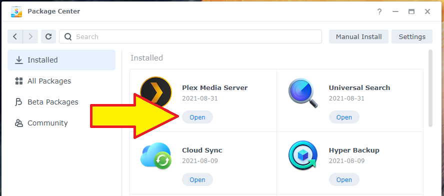

In addition to Trumpy’s excellent instructions, you can also look in the Synology Package Center.
Login to your NAS, open the Package Center, click on Installed, find Plex Media Server and click on Open. This will open a new browser window for you to login to Plex Media Server.
If you are viewing the Plex Media Server details, you can also click on the URL in the lower right corner.
